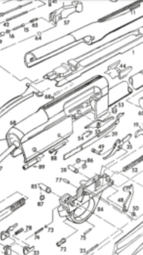

I got out and tries my 11-87. Still not feeding shell in. Just pops out magazine and not tripping the fork like thing that put it in chamber.
So i decided to pull apart and clean again and go over real good. But a thing poped.out that shouldnt have. Think its called a feed latch. Looks like it was in a slot that had peen maks on it to hold in. Will post a pic of part im talking about. I dont think this was the problem though cause it cant move when in place.

Seems to be a common problem. I agree that the latch falling out when the trigger group is removed is not the issue.
I have a couple of pumps that the latch falls out when the trigger group is removed.
Here's a thread on the fix for the latch.
http://www.shotgunworld.com/bbs/viewtopic.php?t=291530
Something is happening to tell the gun that the magazine is empty. You might look for that.

I still think the fork thing the bullet hits to send up to chamber is too stiff.
