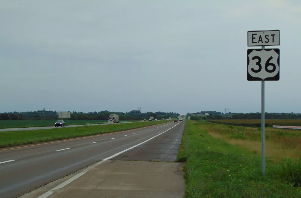

The first I have heard of this :

Enjoyed reading of veto of 1/2 billion$ in spending. If only it could've been more than 1% of the budget. And woodent that be intra state rather than inter state?

My bad! Hanibal at hwy61is one end of existing I -72 , so getting Federalies on board wood be needed to buy up all those acres of good crop land along there.

I am not sure it really needs changed to an interstate, it’s already 4 lanes from St Joseph - Hannibal The cost will be exponential & I can’t see a lot see a benefit. As you stated there will have to be a tremendous amount of ground bought up & I can’t see a lot of those folks willingly selling their land.
There is an ethanol plant in Macon that will have to be modified & a large MFA grain elevator outside Hamilton let alone all the small towns along 36 that will be gutted or destroyed.
The state of MO & the federalies would have to get together & agree on things as well.
BUT we are talking about gubermental spending & potential overreach so…
