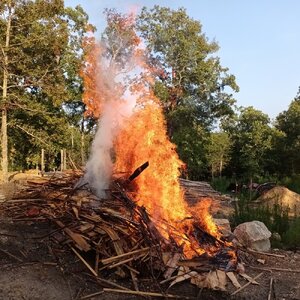

I was able to get the scrap pile burned, so there's that..IMG_20230801_190702.jpg
