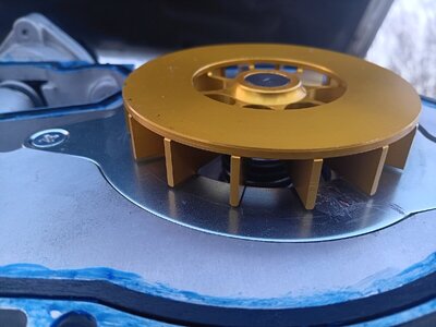

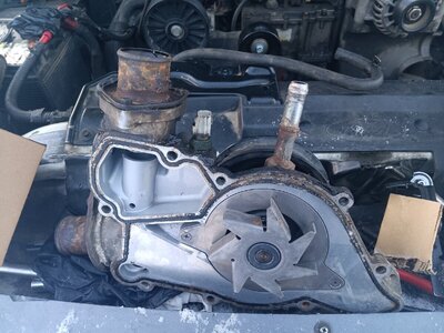

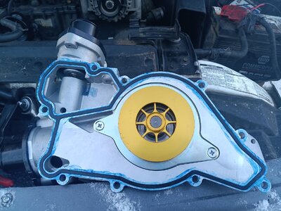

A balmy 1 degree positive, swapped in a new water pump in the 7.3 powerstroke, degas bottle, degas bottle hose, thermostat, thermostat housing and lower radiator housing. Now it's 23 below zero, so dodged that bullet!
I REALLY like the Flowkooler, machined/anodized impeller designs. This is my 3rd flowkooler pump. Have them for my vortec 350 and 292 chevy. Castings are flawless! Castings are by USmotorworks in Santa Fe Springs, CA

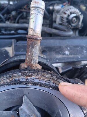

I did not like how much corrosion formed on the old water pump gasket surfaces. So lightly sanded front engine cover, cleaned everything with alcohol and dressed the gasket with permatex permashield.

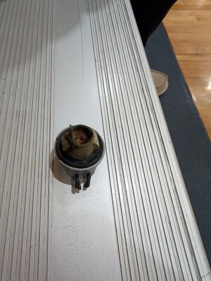

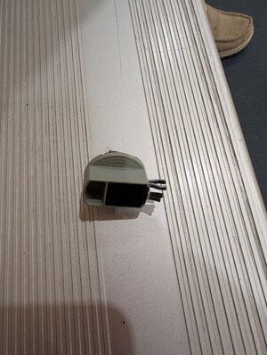

Hey, anybody know where I can get a third brake lamp socket for a 2004 Chevy Colorado? All I'm finding so far is the whole assembly which I don't need.
