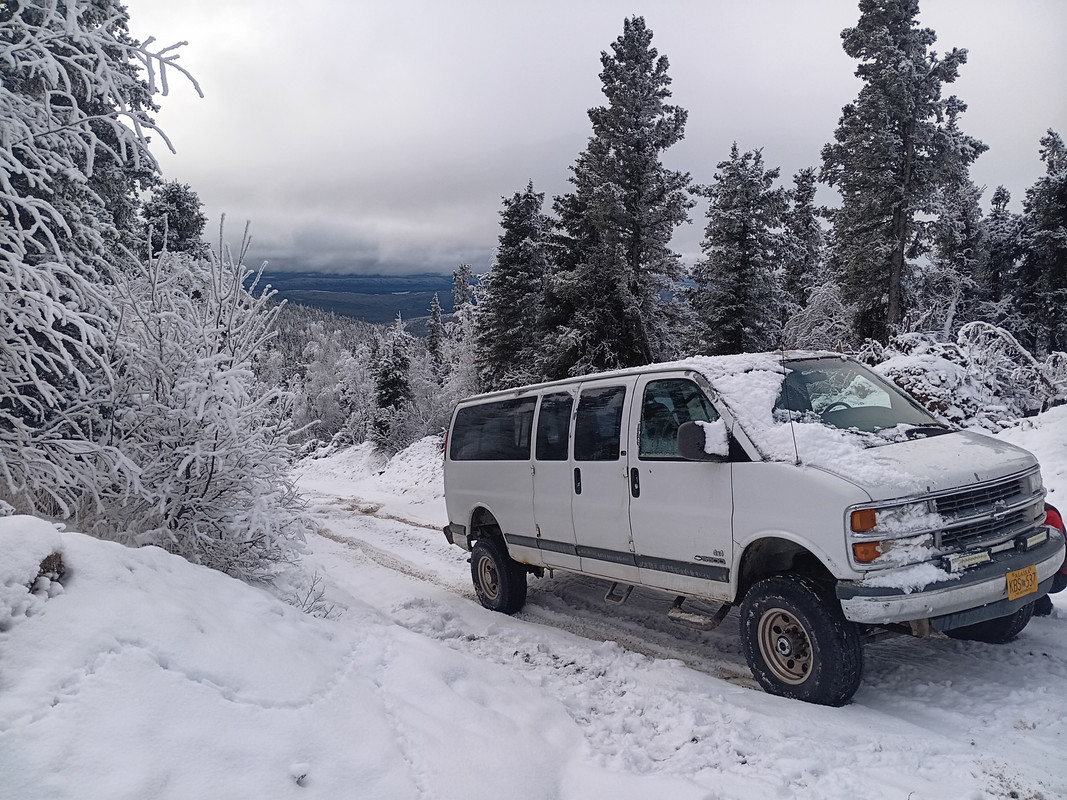

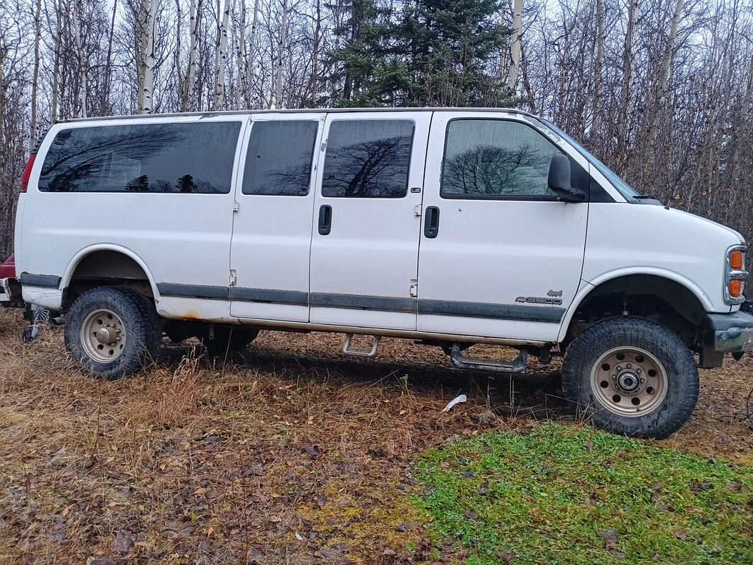

Standard mechanic inspection/Shake down run:

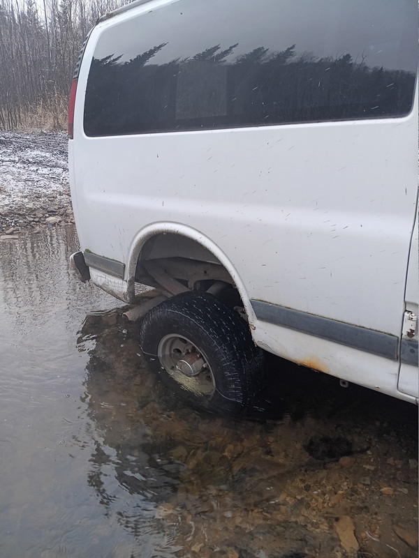

A mining exploration company ran a dozer up buck mountain this summer. Used to be rough, boulder-strewn and bad washouts. ATV only. I tried smashing the van up there. Chicked out 1/4 mile from the summit. Lost momentum on a steep section and the van starting sliding down the hill backwards! If I had chains, wouldve been no problem. Got turned around, and aired the tires down. Crawled my way back down in drive-1 4 low. Couldn't get any momentum or I'd slide like a tobogan.
What i found wrong so far:
1. Wrong shocks up front, too long. Bottoming out against the shocks and not even touching the bump stops.
All that bouncing n jouncing up the mountain knocked loose some crud from the lifter valley. Thing sat for 7 years with sht oil. Could hear a lifter tick when i got home. Ran some fresh oil, tick didnt go away: sticky lifter. Looked over at my 7.3 powerstroke bench and grabbed a 16 oz bottle of hotshots stiction treatment. No fkn joke: tick went away in bout 2 minutes. Whatever was sticky in the valvetrain was cleaned out!
Front leaf springs are too mushy, needs an add-a-leaf. Springs measured 42" long x 3 inch. Weird spring. Something 3" wide x 25 " long add-a-leaf will be hard to find.
Tranmission was a quart low on fluid. Weird torx drain bolt is stripped out. So will just get a new pan with normal drain bolt.
On the climb, kept er between 3000-4000 rpms the entire climb, drive 2, 4wd-high range. The exauhst manifolds were glowing orange.
Couple sections i floored it to redline. Fkn motor had pull up top. An 80 series landcruiser, falls flat on its face at anything above 3500 rpms. Not sure what the cam specs are be she pulls hard off idle, and caries some fkn punch all the way past 5000 rpms. Very broad/linear power delivery. Torque convertor was right on the money. Would start moving the van up hill, just above idle.
Vortec 350 got plenty of power to move all that heavy 1 ton drivetrain. Does need truetracs front n rear though.

If you can find leafs the appropriate width, but longer to sit in the spring pack where you want to locate, just make them the appropriate length with a cutoff wheel. Universal add a leafs were usually like that back in the 90's when I started on cars. Cut to fit many springs over the years.

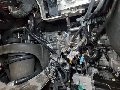

I have today off. Sat in the woods this morning but the deer didn't cooperate.
Pulled the valve body.
All 7 check balls present and accounted for..
I'll take the valve body to work on Monday and disassemble it. If I find nothing there, then the trans needs to come out.

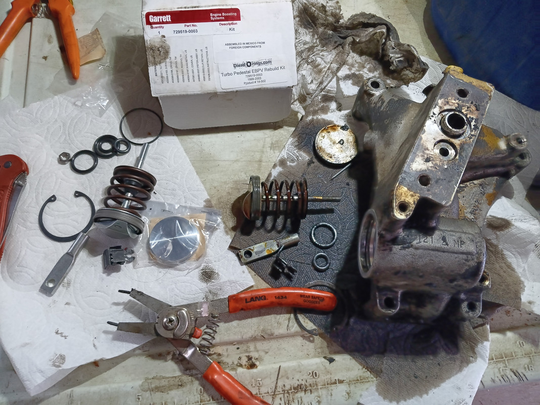

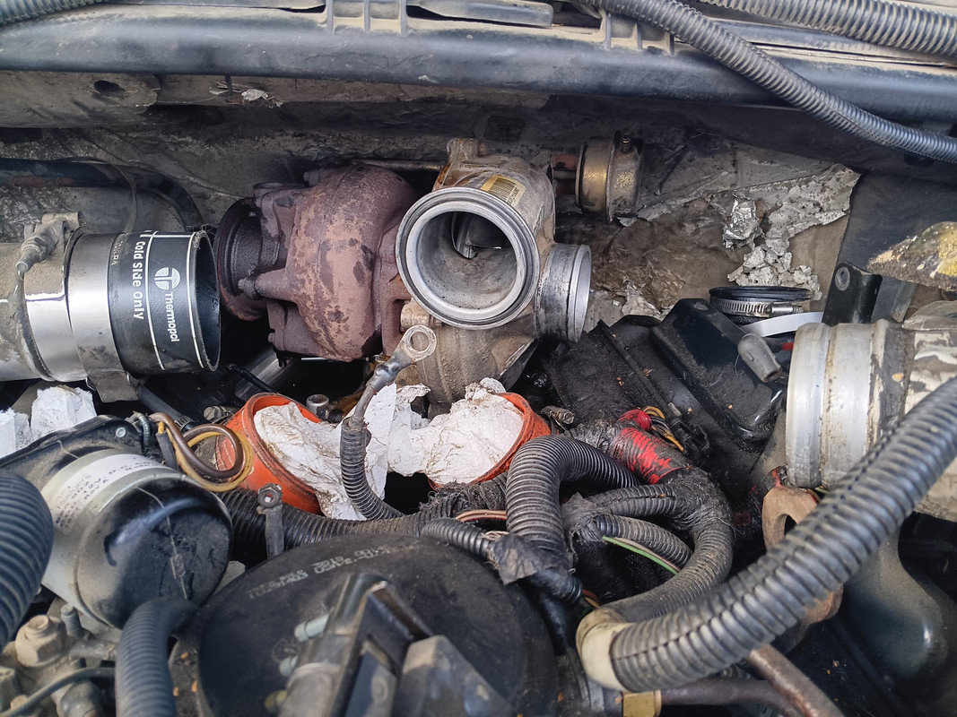

Rebuilding a leaky 7.3 Powerstroke exhaust brake pedestal (EBPV) today, using the Garrett kit. Though the cool kids like to delete this, for bigger power and bigger turbos, Im keeping it.
When the temp sensor registers cold weather, the computer sends a signal to the EBPV to send pressurized motor oil, and uses this to actuate an arm. This opens/closes an exaust break inside the factory turbo to keep heat against the heads, rather than letting it freely flow out the exhaust.
Its a nice feature when its 30-40 below zero. At the same time this happens, the engine high idles and turns on an air intake heater. Once the engine gets to temp, it all shuts off.
The cool kids also delete the heater, for more "turbo" flow.
Having rebuilt the turbo with a kc balanced assembly and a banks bighead wastegate, I easily get 28-30 psi of boost towing heavy trailers:
Really no need to delete these cold weather features, my truck has plenty of power.

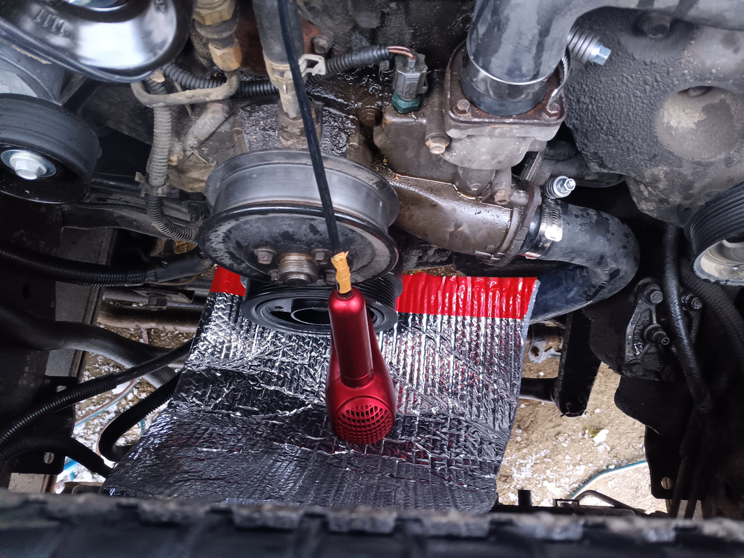

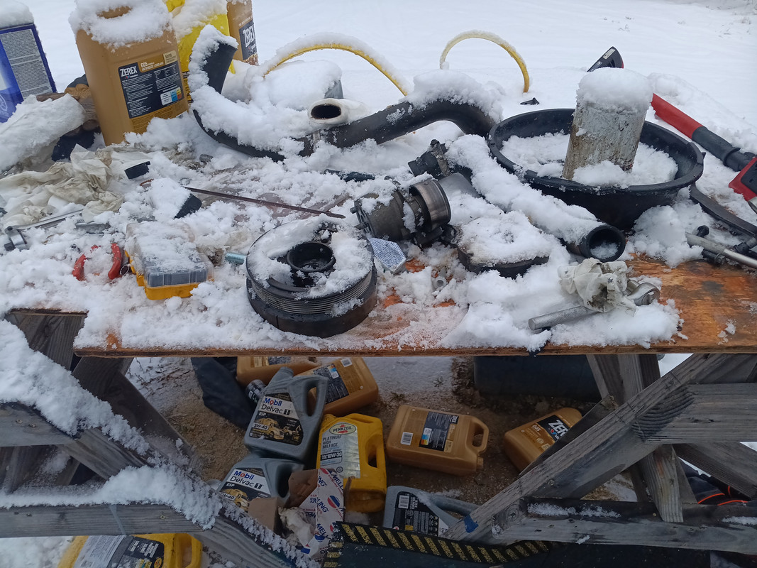

Well she runs and I feel abused. The job went way too far into the late fall season. Im fkn sore everywhere, and my hands are cold and beat-up.
Replaced weak low pressure oil pump, replace leaky turbo up-pipes, 5 gallons coolant, 4 gallons oil, new idler pulleys, new serpentine belt, new belt tensioner, new harmonic balancer, new upper/lower radiator hoses, rebuild leaky exauhst brake turbo pedestal, new high pressure oil line fittings.

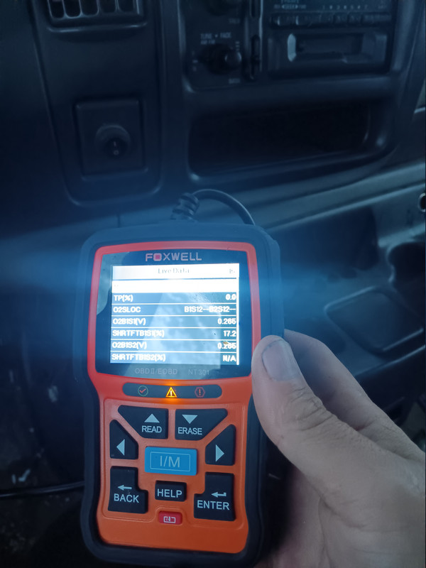

Then all that brutality with the ford, had a check engine light in the chevy. Read the code: p0102, check live data no mass air flow signal .
Clean the connector with electrical cleaner, immediately showed maf signal in the live data. Clear the code and it never came on again.

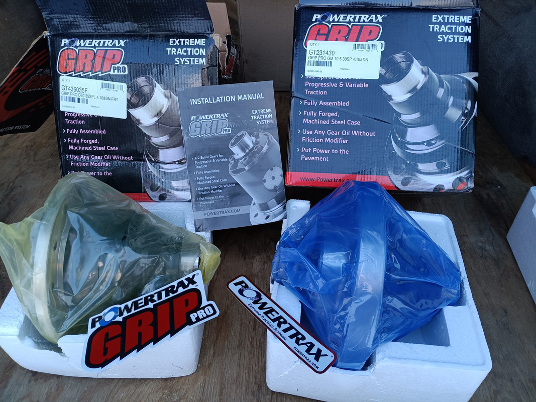

Just a heads up:

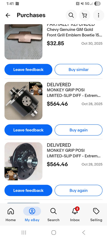

Those monkey grip limited slip differentials from national drivetrain are just rebranded powertrax grip pros which are a hellical limited slip like a Truetrac at half the price. Bout the cheapest price around. They're sold on ebay.
Ill let yall know how they perform in the front dana 60 and 14 bolt rear axles (4x4 van).
This is what came in the box:
