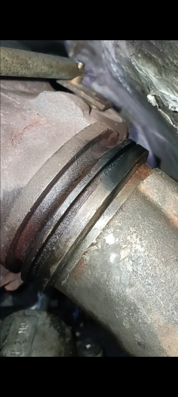

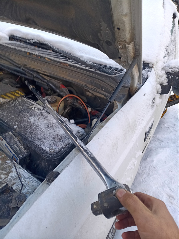

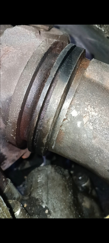

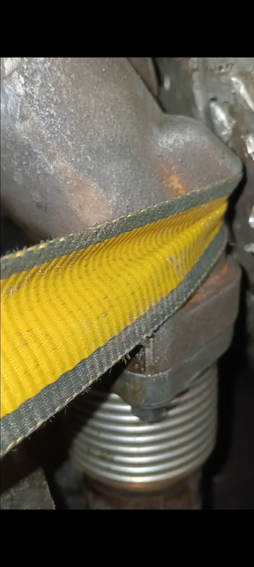

1st test run: Bad exuahst leak. Turbo to up-pipe flange. The tolerances are so tight, the turbo clamp can't be relied upon to cinch it all together.
Those kc turbos nerds only show one method with everything out of the truck. It didn't work:
I walked away from the vehicle when I thought of lighting it up with a 12 gauge.
After rest, an idea came to me:
Get a camera back there and see where the misalignment is, with the turbo clamp removed. It was maybe at most, a 1/8" misalignment at the bottom.

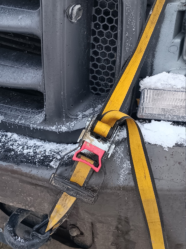

Nobody has mentioned this anywhere, but what I ended up doing was fishing a ratchet strap back there around the back side of the up-pipe flange. Hooked one end to the rear engine hoist eye, the other end to the front tow hook. As I cinched er down, I tapped on the up-pipe flange with a 4ft breaker bar. She went home!
To work on everything was aweful mechanic yoga:
Place tools on woodstove to get them warm to the touch. Race outside and have at er before those tools go back to single digit temps.
Jam forearm between turbo and firewall till your bleeding. Rest forehead on lip of firewall. Laying completely over top of engine, rest sternum over top of alternator.
Bolted the turbo clamp and then removed the ratchet strap. Massive exauhst leak gone.
Misalignment:
After ratchet strap + breaker bar taps:

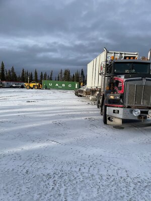

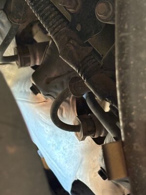

Broke an injector line on my KW about 40 miles from home
Drove it home tried to get as much snow dust on it as I could
Had to rob a line of my backup truck, which would have been a quick job, but it’s a Western Star with a 4 cylinder air compressor. So it had to be removed before I could get to the injector end.
No pics I was under the gun to get it fixed as I had another trip to do tomorrow for another load of sea cans IMG_3076.jpegIMG_3087.jpeg

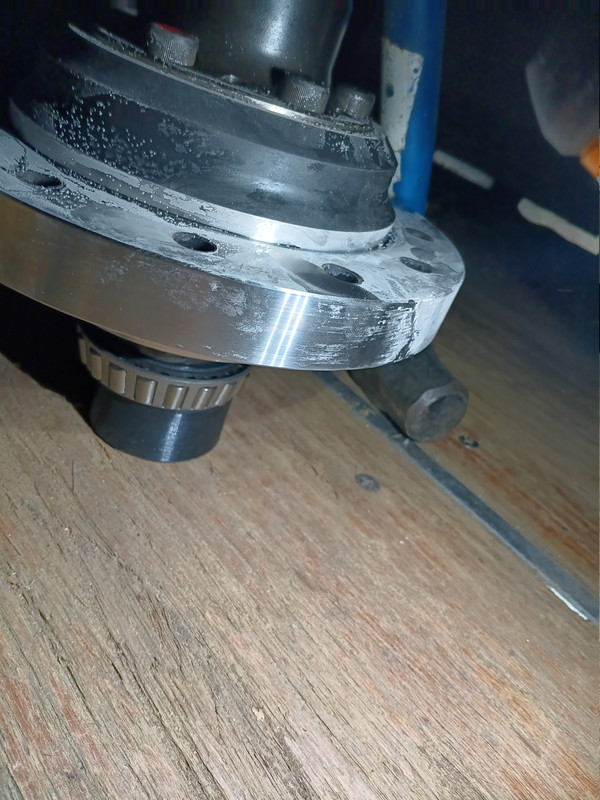

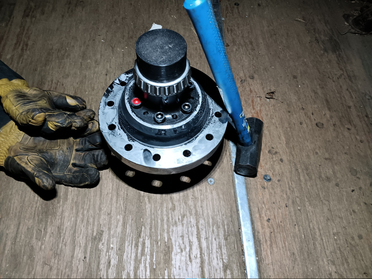

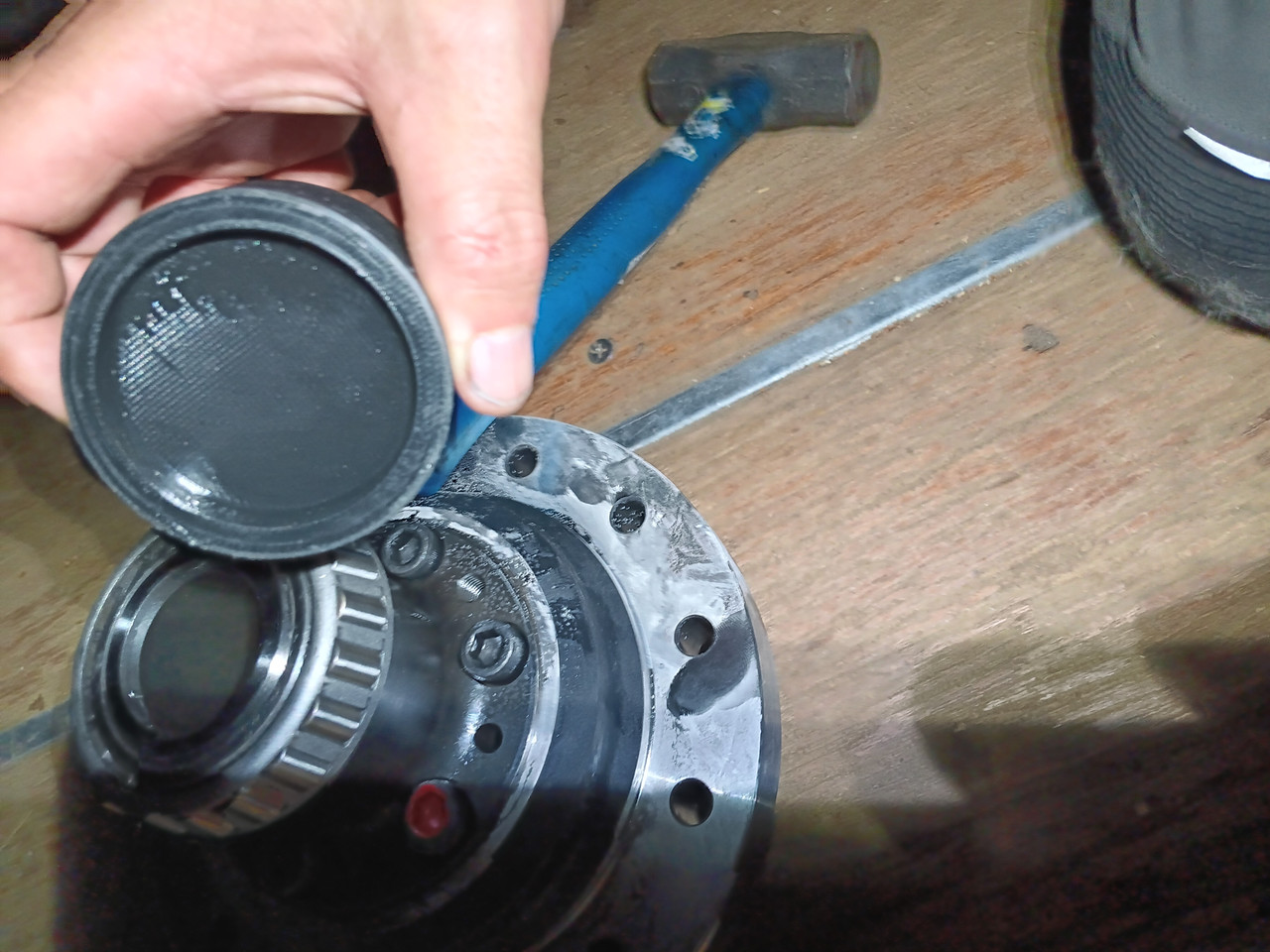

New timken bearings on the grip pros. Put them bearings on the wood stove at 300 deg. F. Differentials were outside at five below zero.
Some light assembly oil and them hot bearings went onto the chilly carriers like butter.
No hydraulic press out here so I tried out the "smash pucks". They're machined from some sort of rugged plastic. They have a recess for the carrier housing and center themselves tightly inside the outter bearing race, sitting perfectly on the inner race.
Them smash pucks work better as a pair so the bottom of the differential (bearing or no bearing) is supported. These smash pucks also be used in a press.
For driving home carrier bearings, they're supperior to using old parts bearings or sockets because them smash pucks self-align tightly inside of the outer bearing race. They don't move around. Smart fkn home-job tool!
Them smash pucks work better as a pair so the bottom of the bottom of the differential is supported. Could also be used in a press.
GM has bearing drivers like that for most of their carrier bearings. I've been installing them like that for many years now without issue
