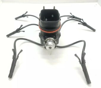

I have used is in my old s10, did a lot of mpg testing with it. It worked the best of all the things I tried, it would pick up 1-3 mpg on average, a friend gave me a half case when he got a diesel
What year s10? I wonder if a little lubricity and detergent in the fuel helped those little poppet valves open and close more efficiently. They're subjected to heat and carbon build-up.
In my old vortec 350/305/4.3 vehicle manual, you were supposed to run a fuel cleaner to keep these little poppet buggers propper.
