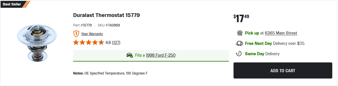

My vehicles all have well over 200k on them and start doing weird chit whenever the season changes, then go back to normal. I've just come to expect it. Do you recall what brand thermostat you used? That is one part where it never pays to go cheap, I've had good luck with the Napa premium thermostats lately.
