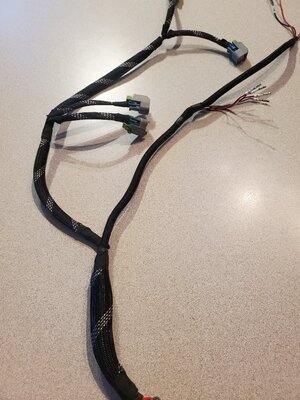

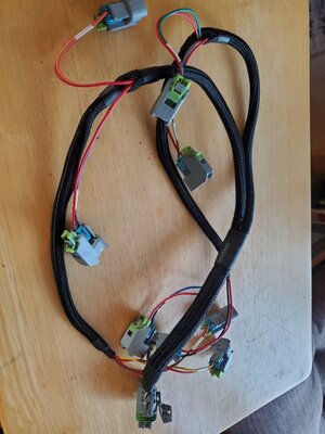

I stumbled across some wire loom that was black and gray. Of course I thought it might look nice..
Well, it's not a split/wrap type and it's a major beeyotch to use.
Thought I would try the injector harness.

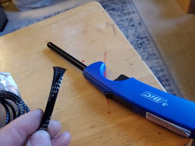

I found that it does this..
Unless you melt the end slightly..
Half done.
It does add something compared to the plain black but I doubt I will be doing much more just because of the difficulty of installing.

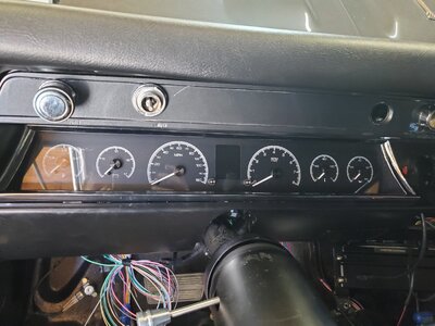

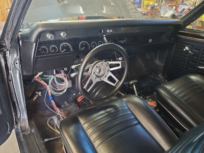

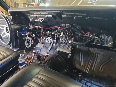

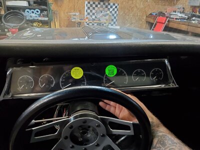

Pulled the dash, bolted in the Dakota Digital and with the help of my wife got it back in with minimal scuffs and a scratch to the panels.
Still need to wire it.
It's their HDX series. I also got the add on integration module that plugs into my Holley system and gets almost all the info for the cluster from there.

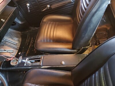

Got the console in too.
And found out the transmission has no 4th gear.
I drove it to my parents last weekend. It goes 1, 2, 3, neutral...
I'm thinking there was a check ball in the valve body missed or a stuck valve.
Seeing it was a GM reman I'm waiting on our district rep to figure out how warranty will happen because they require dealers to connect every cars dlc to their system to prove it was actually at the shop.
This car not only isn't application correct, it doesn't possess a modern 17 digit VIN or a standard DLC due to the Holley system...

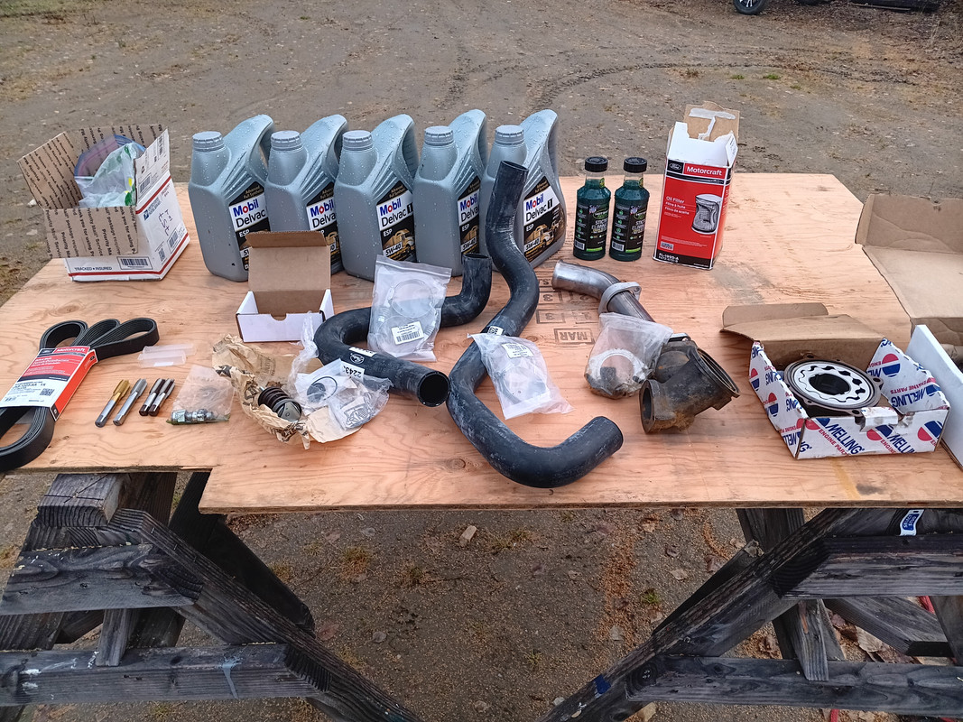

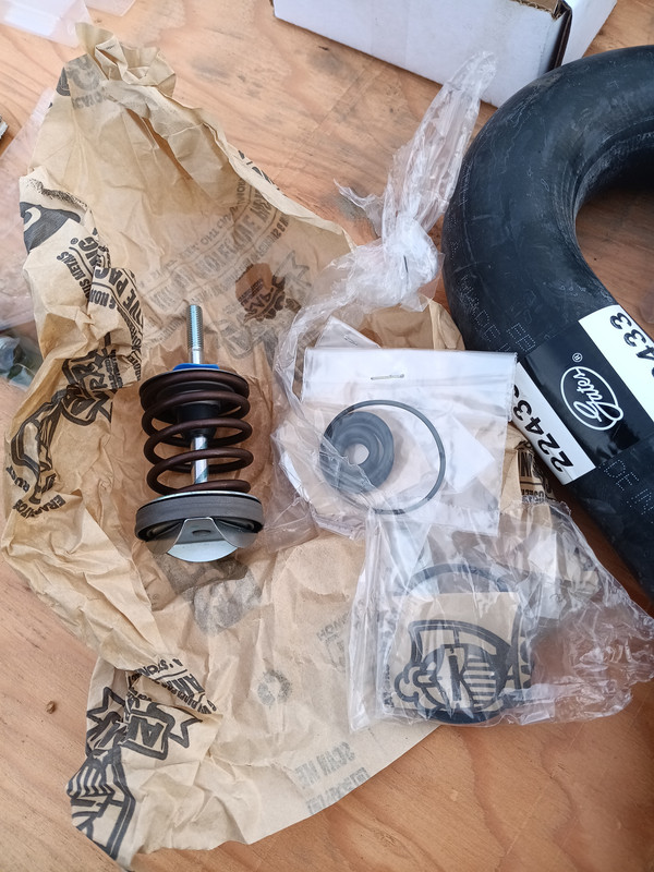

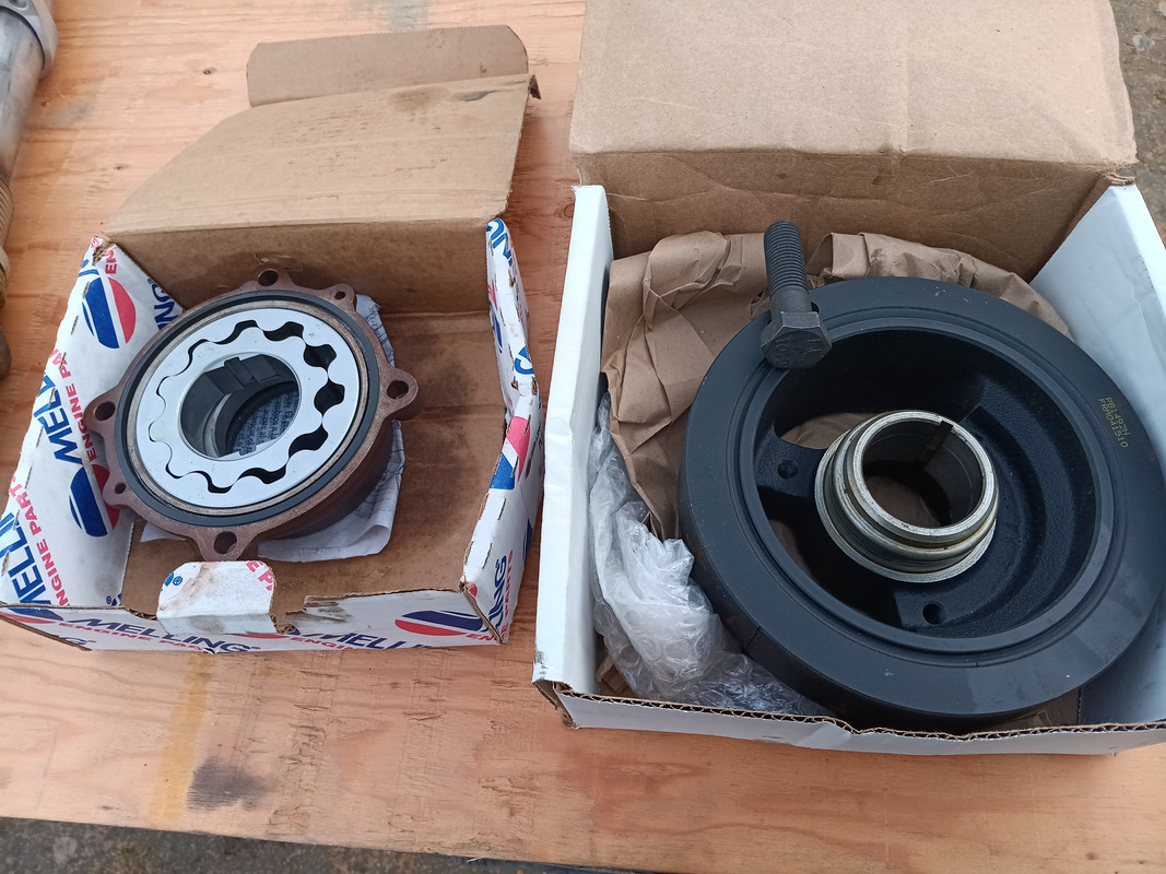

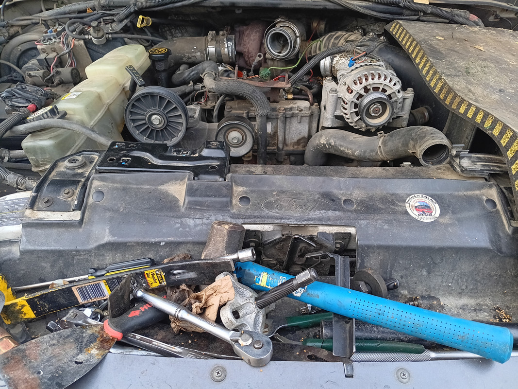

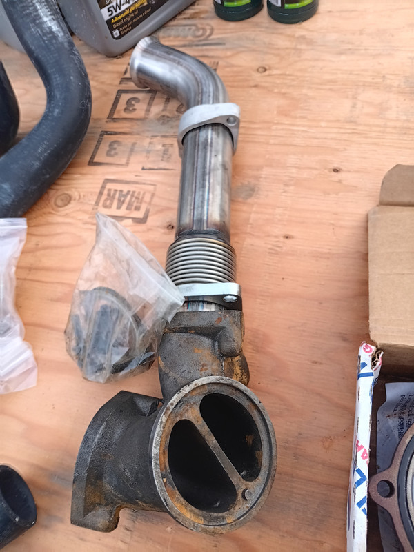

Uppipes (manifold to turbo) are leaking in the ole seven-three wood truck. Can smell diesel fumes in cab at idle.
LPOP(Low pressure oil pump) worn out too. Long crank, no oil pressure feeding the hpop which is what operates the injectors. Oil pressure registers on the dash after 3-4 long cranks
Turbo pedestal/exauhst brake leaking oil. Garrett offers a rebuild kit
254,000 miles.
Big job, via the mobile mechanic set. Im getting too fkn old for cold rusty metal yoga, on an interior Alaska October. May would be better month, before mosquito season starts. Oh well, I procrastinate mechanic work sometimes, till it builds up into a giant last minute job. 😄
Well Im in there, might as well replace harmonic balancer, belt tensioner, idler pulleys, serpentine belt, radiator hoses, coolant, harmonic balancer bolt.

Low pressure oil pumps actually do get worn enough where the hpop reservoir will drain back down. U can also here a smidgen of turbo bearing chirp till the oil pressure builds. The melling high volume oil pump is a good replacement. More oil pressure at start up and at idle.
