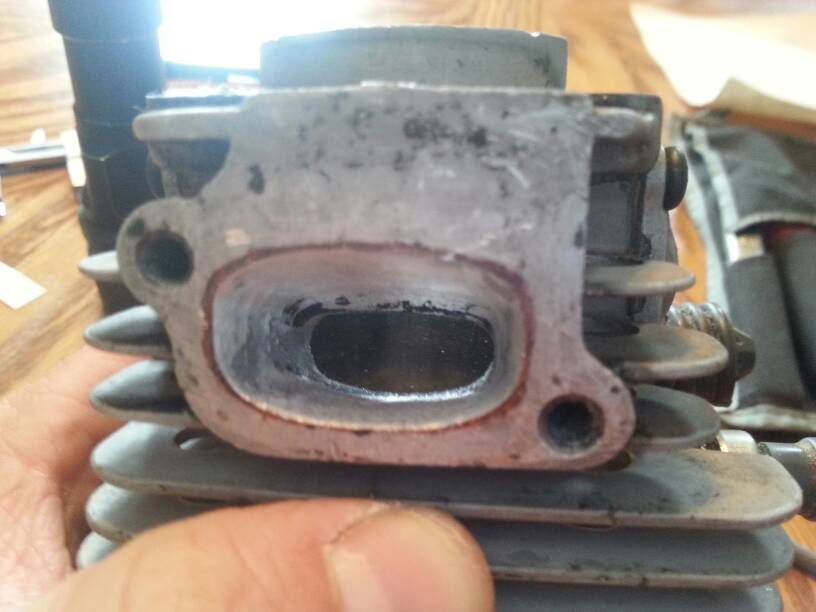

Well what ya think. i i did a little grinding on the exhaust port. I stihl gotta put a little bevle on the inside. And sand the port to smooth it out.
Should i open up the outside where muf attaches a little more?

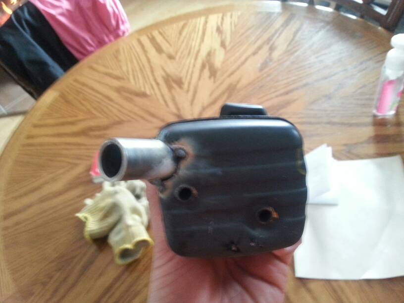

First muff modd too. She gonna be one noisy sum beech. I cant wait.

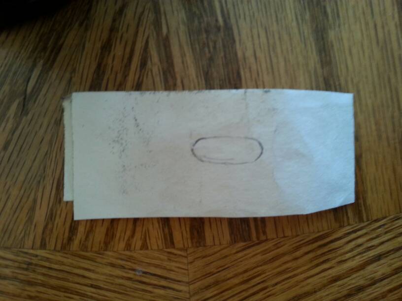

trace the exhaust.
you want the sides as symmetrical as possible. the consequence is the ring will slam into the pin and the pin ends up coming through the top of the piston.

Also way to go on jumping in with both feet.
you can smooth out some of the bumps in the exhaust with a sanding drum, you don't have to go crazy just knock down some of the bumps.

I will retrace on paper and check. I been sandind it some with a peace of sandpaper wrapped arround a pencil. What a pain lol. Got it not too bad so far.
Thanks for the tips.

Wont get a chance till tomorrow to trace and post a pic.

trace the exhaust.
I think i got it pretty close. Just got to put bevel on and clean it out.
I never did anything to i take side. The ring end are pretty close to the opening.

For muffler should i close factory port with the short pipe i put on?It aftermarket and wide open. Nothing inside.

I'd leave the factory port as is. Is it running yet?Ha

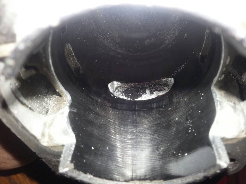

Uh oh. I went a little deep at the trasfer case and got an air leak. I tried putting the gasket glue on it and gonna try set till tomorrow after work. Hope i didnt bugger it. If it dont hold i may try jb weld as a last ditch effort. Other wise it will be a lesson learned.
Anyone else ever do that and any ideas for fixing

Sandpaper on a pencil or I use a flat file with sandpaper around it,it will make the port flat and smooth. A 7/32 file works good too.
Your grinding looks good,it's work to be proud of. Should be a runner.
The thick pipe you used on the muffler will help with noise just don't let it stick out farther than the dogs.

Assuming I understand what you did, not to worry, that's pretty typical, would probably go with the jb weld though.
When I go particularly deep cutting squish and need to raise the transfers a lot, I more or less expect to bust through somewhere.
Worst place for me is the upper exhaust side corner (transfers) when trying to flatten the roof and get way back in there.
IIRC treemonkey will build some of them up with epoxy beforehand with the expectation of going through, easier to do before there's a hole.
I've tig welded first while there's still some thickness to work with, really tough to do after they're eggshell thin.

Well i think its almost ready. I presure checked it and the only bubbles are from the decompresion valve. Gonna pick up a plug today and retest tomorrow. Iv never used it but must have pushed it in when working on it and it wont seal up now. Dont know why a 50 cc saw needs one any how.
