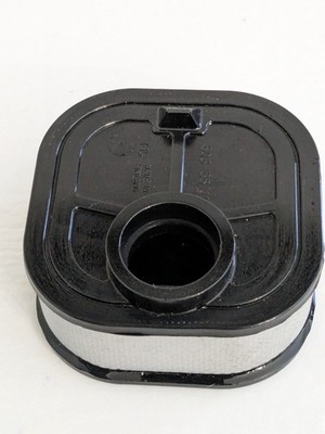

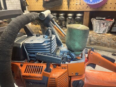

Anyone have one of these laying around? It’s a nylon HD filter. Or any other ideas? Maybe a green weenie could fit under the hood
It should run fine with a new clean HD filter. https://www.hlsproparts.com/HD-type-air-filter-for-Husqvarna-268-272XP-p/h50272.htm

I have redbeard’s foam filter & velocity stack on my 372, and the yellow pleated HD filter on my ported 395. Husky’s HD is fantastic. Very easy to knock the large chips out of and keep clean. Filters really well.
(Especially the HD filter for the 395, which is about law large as the one you find on a 25HP riding lawnmower. 🤣 )

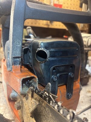

Testing tomorrow… heat cycled tonight. I can already tell the filter is choking it up. I need a better flowing filter option. It has the pleated HD filter now, but maybe the smaller mesh regular style filter will be better if I can get my hands on a setup. Timing is advanced and muffler is modded, but I also think not enough.
Run it without the air filter and see if it gets better. It could be plugged up, but I doubt it’s the actual air filter design. Only one I’ve really had trouble with is the 026 sucking the choke closed
