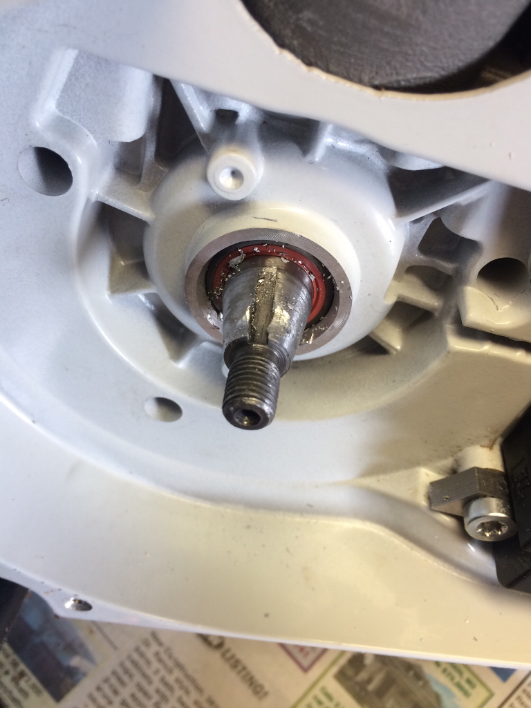

Fun with Farmertec 361 #2 was short lived. Stopped sudden like coming out of a long buried bar cut.[emoji15]
Nut (flanged, thank you) came loose. I had blipped four times with 1/2" impact.
End of crank looks soft to be rolled up like that.
New Rule:
Blue Locktite for flywheel nuts from now on!

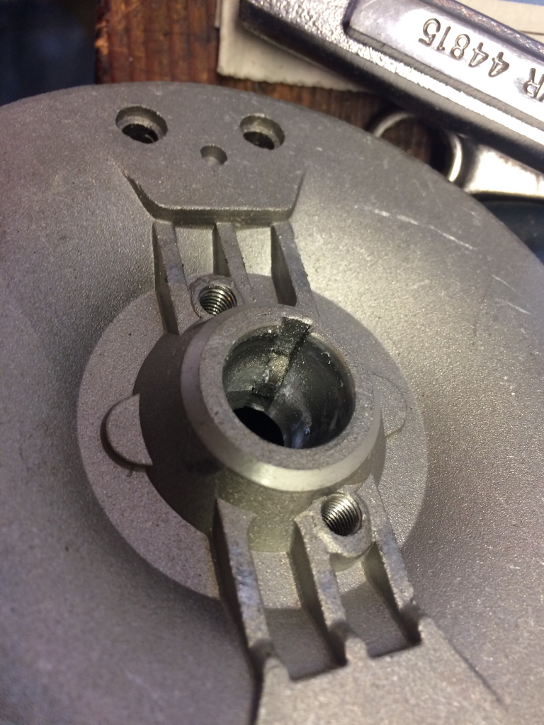

Coil poles look fine. Just a minor scrape.
Crank and flywheel cleaned up OK with a Swiss pattern file.
I plan to make a tapered key starting at 3mm square x 5/16" long. Use as much of the keyway as possible.
I'd Be tempted to use valve lapping compound between the crank and flywheel to ensure your taper is a perfect fit, might bind better next time as you shouldn't need a key to keep a proper taper fit in place. Chances are they weren't just matched up properly from factory

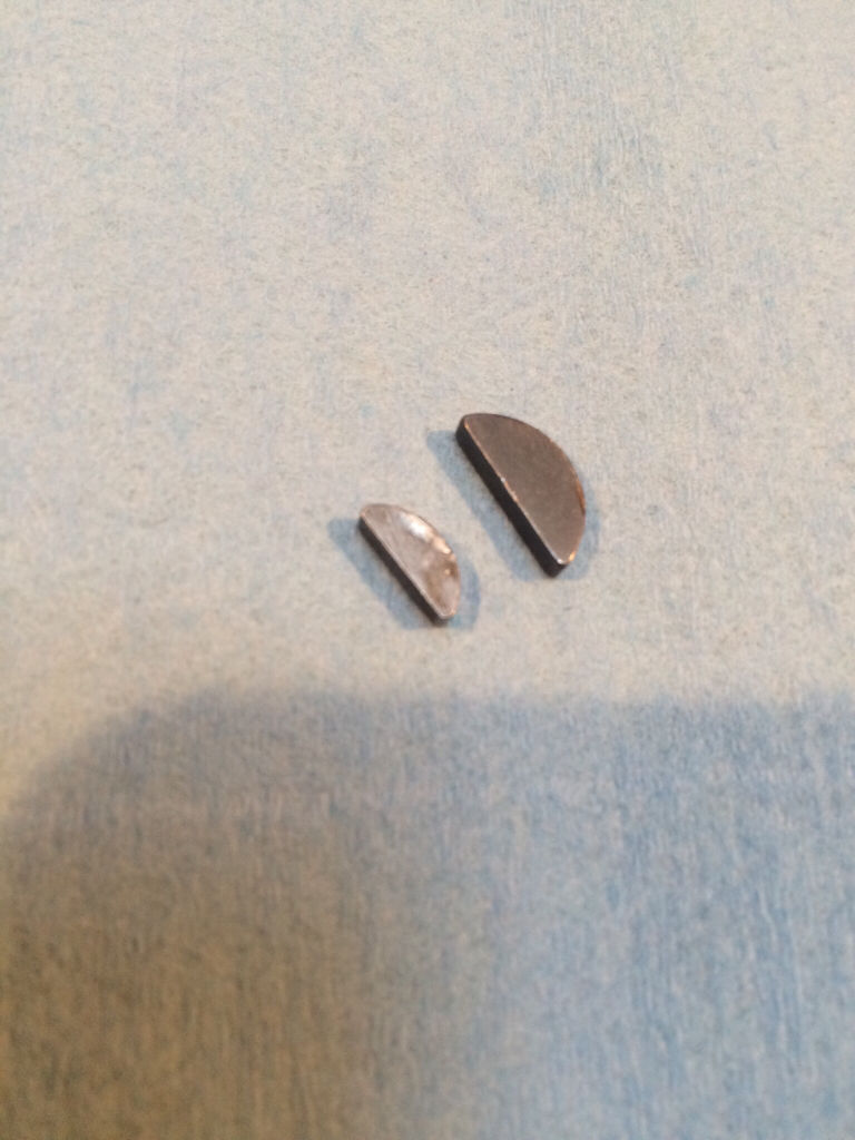

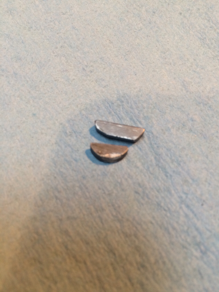

No 3mm square keys at Ace so we improvised.
Original key left and a 3x7x5 woodruff key right.
Filed down to remove the 'belly' and tapered a touch to better fit the keyway.
External Star lock washer under the nut and blue Locktite.
Check ride tomorrow after the Locktite cures good.
