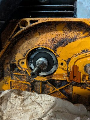

Here is a photo that I took before I pulled everything apart. You can see the sealant at 2 and 9 by the crank. I think this uses the separate seals and bearings, but will need to open it up to confirm.

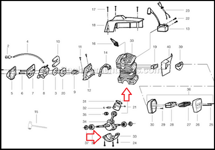

Now that I look at the IPL, this Poulan is basically a Husky 55, it has a clamshell cylinder which requires using a sealant between the cylinder and the base plate. Some people even put it around the bearings too to prevent air leaks, so I would say that black sealant is supposed to be there. If you do remove the cylinder, you will need to clean off all of the old sealant and replace it with new sealant that is fuel resistant....this is very important, was chasing my tail on my saw until I realized I was using the wrong sealant!!
The diagram below with the red arrows show the base plate and the cylinder where you will be placing the sealant (no cylinder gasket on this saw).

Seals appear to have been leaking. I think someone put the sealant on them also, and it doesn't look like it stayed put. Or at least it didn't bond to the metal and the rubber/plastic on the seal surface. There is a lot of what looks like uncured sealant, maybe just regular black RTV was used and not something fuel safe. Im going to order a new set of seals along with the carb holder/intake boot and the bar oil fitting and will try to get this back together.

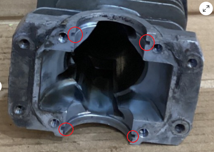

Follow the instructions on the tube, I know others use Dirko, I think I have another brand, maybe Permetex, can't think of it off hand, basically with the stuff I have, you clean all surfaces very well with acetone or something similar, then spread a thin layer on all surfaces that will come together (clamshell bottom, cylinder and bearing pockets. Ease everything together without smearing the sealant, tighten cylinder bolts until the sealant comes together and just starts to squeeze out slightly. Wait one hour and then tighten to torque spec. Let set for 24 hours before running saw.
You want to make sure you get a little extra sealant in the notches where the bearings set, this will greatly reduce the chance of an air leak, usually the stuff flows well against all of the other surfaces, but these pockets on the cylinder and the base plate need a little extra.

Dirko HT is highly recommended as fuel, heat (up to 315 C) and plastic safe. You don't need the sealant in the entire notch, just where the cylinder and base plate come together, with the seams and the seals meet up...there is the greatest chance of air leak. Trying to find a happy medium is the trick, too little and you can get an air leak, too much and you have a mess and dirko balls bouncing around the cylinder until they are spit out and captured by the muffler.

Should there be sealant where the flange sits, just where the edge of the seal hits, or both?
I have had good luck with putting it on the flat surface of the cylinder (obviously) and right where the red circles are, I have not put any in the groove pocket the seal slides into. I have seen a few people on YouTube that do put some there so you should be good to go either way. Usually once I get the crankshaft/bearing assembly in the cylinder and seated, I will revisit the four red circles to make sure there is still plenty of sealant there.
