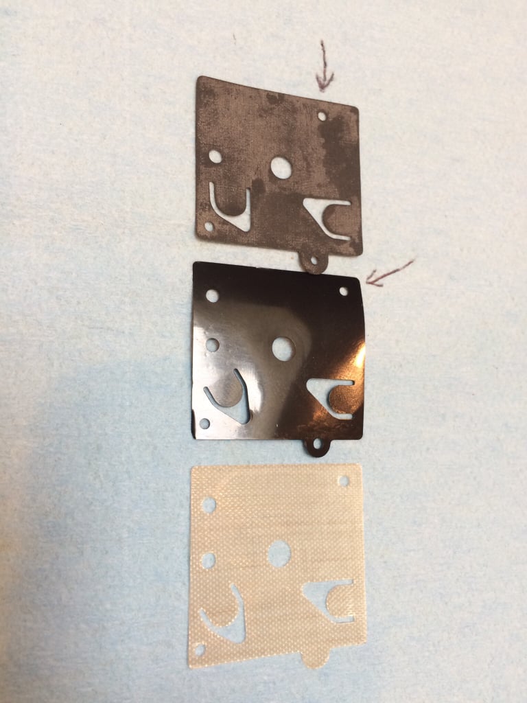

Not what I was hoping. Common problem seemed to be high idle and poor low end. Guys were finding that there was poor sealing around the throttle butterfly...replacing with an OEM made all the difference.
Did you try an OEM fuel pump gasket to see if that help? I heard the ones in those carbs are pretty stiff. Could cause an issue.
67L36Driver
10:53 AM
596
9,675
41,665
Yes, the pump diaphragm contained in the Farmertec carbs are really stiff plastic.
Middle below.
Rubber fabric type helps a lot. Top.
Going to try the more common style (bottom) next as the rubber one don't fit correctly.
Middle below.
I think the bottom one was said to be the most ethanol resistant. I always use that one if I have a choice
