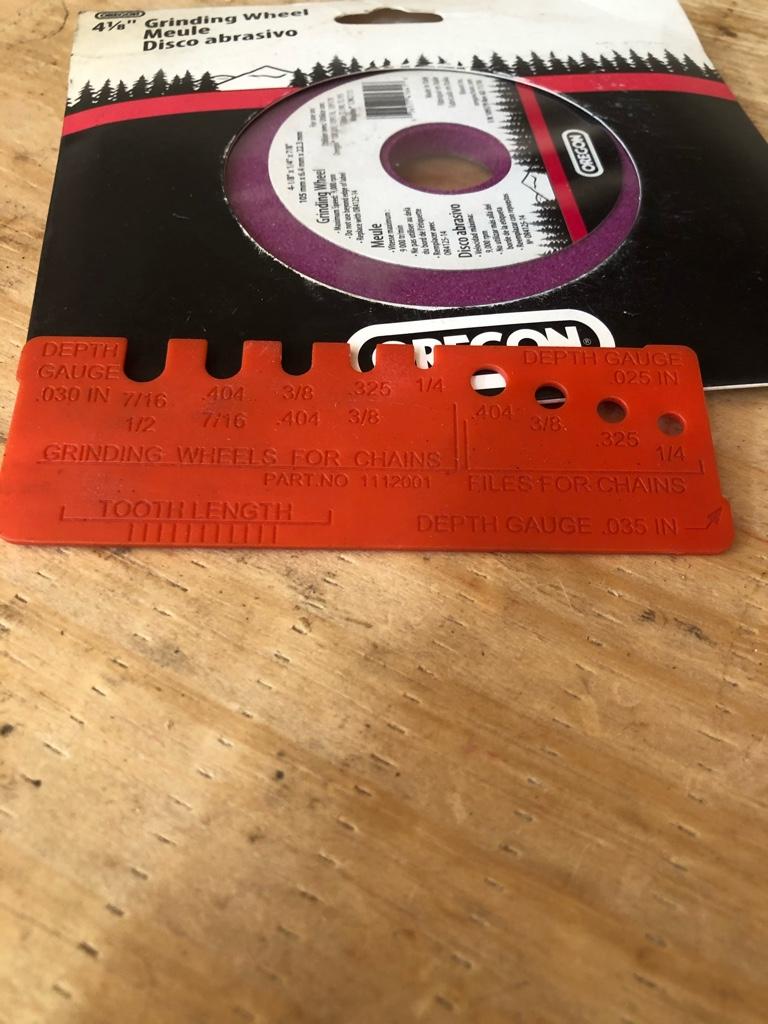

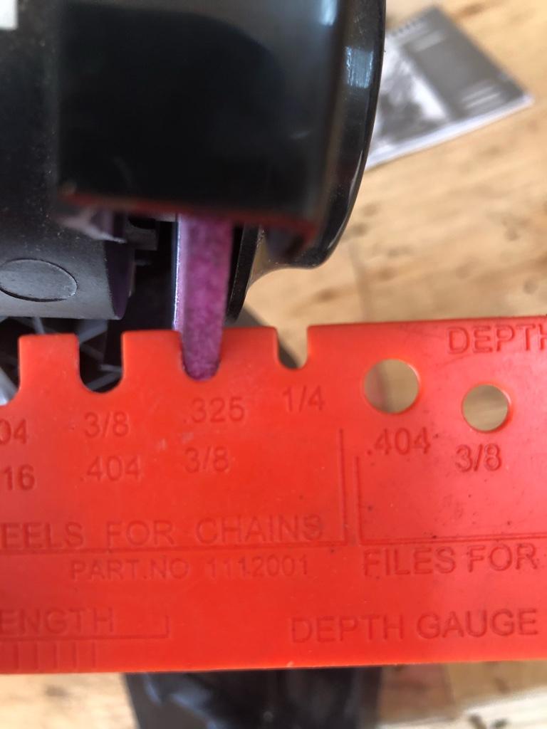

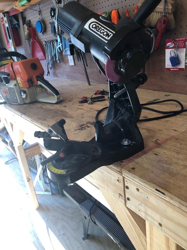

Ok guys this should fall inline with the thread topic here I hope. I have a new to me grinder I purchased from another member here that worked fine for them I have no doubt. Only difference is they were using a CBN wheel on it where im using an Oregon.
The grinder is an Oregon model #108181. I’ve dressed 2 wheels for the .325 and 3/8 per the little orange guide that comes with the grinder. Ground the chains then checked the rakers. Angle is set to 30. The motor head arm is fixed position and do not know what it is.

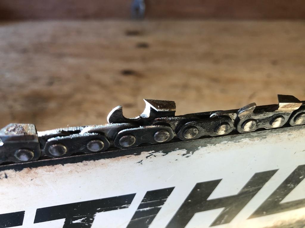

I ground three chains and all looked good but once you put them in the wood they wont cut and will actually start smoking. Im doing something majorly wrong.
I can file them sharp by hand no problem but this grinding thing is new to me any help would be appreciated.

Had to tell from your photo of the chain. That grinder has a fixed head angle, probably at 60°, which may be different from what you hand file, but should still cut. Couple of questions:
- Did the color change on the cutters as you ground (red, blue, or black)?
- Can you hold a filed cutter next to your ground ones and see a difference in the edges (top and side)?
A light touch on the grinder, and a well dressed wheel, can address both of those issues (if present).
I looks like you may have taken the wheel pretty deep into the gullet, where you end up sharpening / shaping with the side of the wheel instead of the rounded edge. Again, hard to tell from the photo.

-The color didnt change. (I will double check) I was careful to adjust the chains a little at a time to where they were lightly touching the cutter.
-Unfortunately I ground all my chains thinking there wouldnt be any issues.
-I did run a file over a few and it felt loose, wouldn’t grab very much pushing through the cutter (so the deep gullet premise might be a factor here)
Let me get some more pictures in the AM and go from there. Thanks
