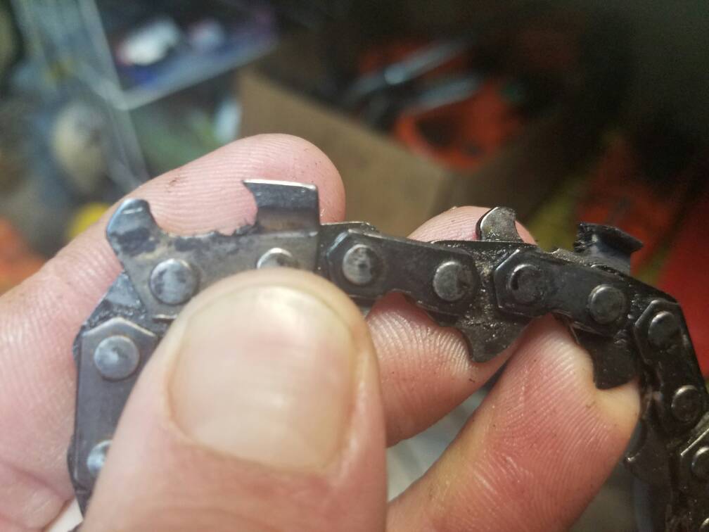

It does sound like case hardened cutters due to overly aggressive grinding. But t4driller said he saw no overheating discoloration. hmmm.
Some more pics trying to show the color of it. There's no signs of being heated up that I can see. The only thing that stands out to me is under the top plate I can see a line. I'm assuming it's the plating and it looks alot thicker then the other chains I have.
The first thing to do is to touch up one of the cutters with the grinder and then see if it is easier to file.
The chrome layer is very thin. While it is possible that the cutter was hardened in the manufacturing process (typically not heat treated properly) it appears to have been sharpened by someone, so I am going with the 'overheated by a previous sharpening event with a grinder' camp, even though you don't see any discoloration.
Typically, as noted, if you grind through that section, it can usually be filed afterwards. Worst case, it may be a grind-only chain that still cuts fine.
