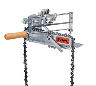

To get us back on track: the STIHL FG-2 has a built-in filing vise, unlike the clamp-on models.

The nylon bushings in mine are worn, but also unavailable here.
That would probably be the simplest option.
The other possibility, is to have a member that lives in the EU (or friend, family stationed overseas, etc.), get the parts, and send them to you.
Philbert
10:56 AM
15,011
59,915
Decent amount of European members here.
Also, plenty of US members having a lathe and/or mill.
I do not know how those FG2 bushings look like, but I doubt they'd be too complicated to replicate.
I made my own replacement Archer FastFiler rollers on a mill, both plastic & steel, and also "renewable" steel ones that get a piece of Oregon fuel line pushed over them.
In case those bushings have a part number post it!

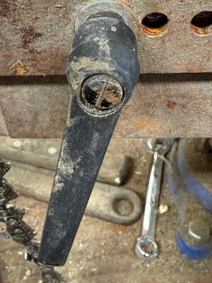

IMG_8432.jpegI think someone asked if those knobs could end up being in the way. So mine has sat in the back of the truck and honestly treated like a tool. If you pull out on the lever after tightening the chain up. The lever then “free spools”
In other words tighten the chain. Then pull out on lever and move it wherever you want it to be.

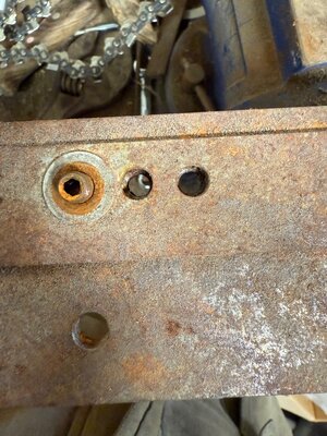

IMG_8433.jpegSo if you remove the knob completely you’ll see you can swap hole positions. I have never had the need but anyway just a review after having and using this thing. I had good dealing with him and would buy again.
