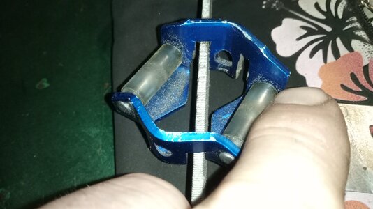

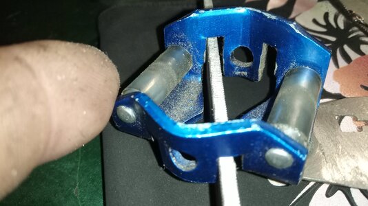

As said, I own a Husky roller guide.
Interference was minimal.
Take a mild file stroke off both sides then check fitment, You don't want it too loose as it'll wobble otherwise.

If I recall correctly I could notice an edge from the stamping process and I just mildly filed that off symmetrically on both sides whilst testing fitment after each file stroke.
As said, You don't want it too loose and it will wear through usage anyway.

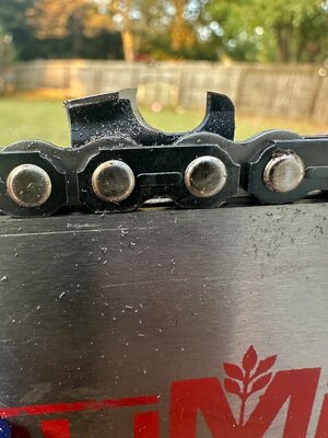

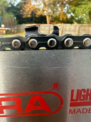

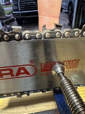

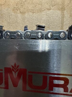

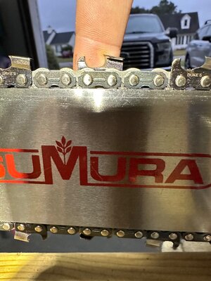

was bored this afternoon and decided to practice some more. The file is still not sitting as deep as it should. It did decreased the hook, I think the angle is far less drastic as well. A few times it was only hitting the area I highlighted red
That will cut OK. You can adjust things to suit the power and wood type you are cutting. A cutter like that will allow a little more depth gauge if you want a bit more cut speed and it will hold an edge well
First picture (0914) is what You should aim for, second picture (0916) You are a bit too high.
The guide still doesn't seem to sit flush on the chains tie straps in the first picture, which may be why Your file is too high in the second picture.
I'd double check that.

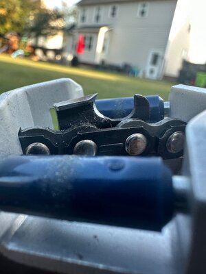

Latest hand file practice. Certainly room to improve. The husky roller kit is worth it for the raker gauge and flat file alone. These look less “aggressive” to my eye.
Trying some tilt, 7/32 file. Haven’t gotten comfortable with the 1/4 @davidwyby sent me. Hit a few with the 1/4 first then finished with the 7/32.

Thats about where I like my chains for bucking hardwood; looks durable with a lot of meat. Also looks like you're getting a bigger bite with the 'C' part of the cutter and not the top, which is also my preference. I'd definitely take the depths down a stroke or two, then round them out. Make a few cuts, and as @huskihl said, if the saw isn't feeding itself smooth (cutting one-handed in a log is a good way to tell) under its own weight, take another stroke or two off the depths and round the top out again.
Edit: A fast chain and a durable chain aren't mutually exclusive. Semi-chisel can cut quickly, and full chisel can be tailored to be more durable while maintaining speed.
