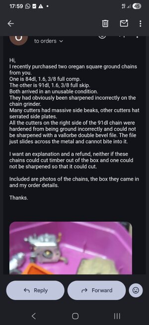

I bought square Oregon from Gordy at West Coast Saw and it's way better than this, cuts great! I'd send pictures of that to Oregon.

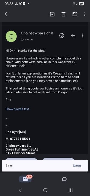

Tbh I've seen a lot of videos criticising oregon square ground chains.It is clear there is an issue with the chain but I am a bit puzzled at some of the comments regarding the box and if it is "knock off" chain. I guess some folks have never bought 100 ft reels or bought loops from a shop that did. The reels come from Stihl, Oregon, etc with boxes that do not have specific information. That is because you spin the loop and write the size on the box or print a tag for it. You can clearly see the seller printed a tag and attached it which is common practice. As for if it is knock off if it is then someone went to a helluva lot work since the tie straps appear to say Oregon. As for if it is factory reject that is a strong possibility.
Just to be clear, I know those generic boxes come with the 100' rolls and use them routinely when spinning loops for customers, but we buy most of our chains in pre-made. The unlabeled boxes do increase the risk of buying something that hasn't been properly assembled or inspected though. I agree that the chain doesn't look knock-off and that would be way too much work to go to. I guess Oregon just doesn't have square ground chain figured out like round ground.It is clear there is an issue with the chain but I am a bit puzzled at some of the comments regarding the box and if it is "knock off" chain. I guess some folks have never bought 100 ft reels or bought loops from a shop that did. The reels come from Stihl, Oregon, etc with boxes that do not have specific information. That is because you spin the loop and write the size on the box or print a tag for it. You can clearly see the seller printed a tag and attached it which is common practice. As for if it is knock off if it is then someone went to a helluva lot work since the tie straps appear to say Oregon. As for if it is factory reject that is a strong possibility.
