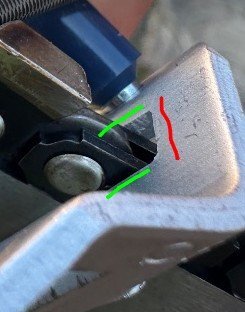

Well I got my roller guide, it’s not quite right for the Dukes chain. Was still worth the price for the flat file and rounds in the kit.
Can I hog out the channels to make it sit lower?
12:00 AM
15,052
60,134
Yes, file out the channels/groove so it settles on top of the tie straps!
I had to do that to make it fit Oregon chains.
12:00 AM
15,052
60,134
File left & right (the sides, marked green), not the top (marked red)!
