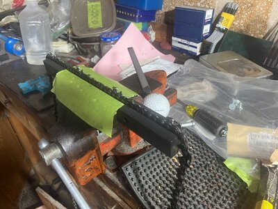

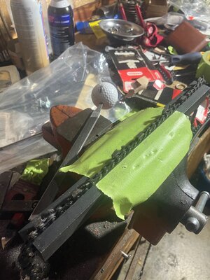

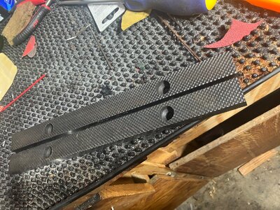

The $20 vise extenders work pretty well. Serrated and much thicker than I thought they'd be. Links are rigid all but one end and that one is more rigid than in a bar. Might be tight all the way in a better vise. Would be 5 a side at a time with full comp 3/8. Half skip in the photo
