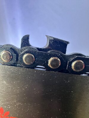

I’m slowly trying to convert from 2 in 1 filing to hand filing. How do you know when you are getting too much hook to your cutter?
Is the fix more passes to get the underside of the top plate? Photo is my first hand file on dukes Orange chain

Remember that you should have 10-15% of the round file above the top plate. If the file is diving down farther in the cutter your getting too much hook.

This^.
Sharper angles cut faster but don’t last as long. Blunt angles cut slower but don’t dull as easily.
When your file is too low, you start to get underneath the cutter more and thin out the top plate at a sharper angle. Like a C shape.
When you raise the file higher, you are making a more blunt cutter like a ( shape.
Yours is close and will cut really well. Like mentioned, it’s just a hair on the aggressive side. But it would work good in soft wood with no knots if that’s what you’re cutting.

All good advice. Something else you can do is put your file in a new chain. Just touch it up lightly going to what's there. Make note of how much file is above the cutter and what angle it's at. Before you get through a whole chain, you'll have it.
In addition to putting the bar in a vise, jam something like a felling wedge between the bar and chain to hold it snug so the tooth won't move when you file it.

Let’s say hypothetically I went from what’s shown in my first post (deemed aggressive) and got too much hook.
What type of stroke brings it back to a more subtle C shape? I practiced some more

Looking at a stock off the reel chain is a good place to start.🤷🏼‍♂️
