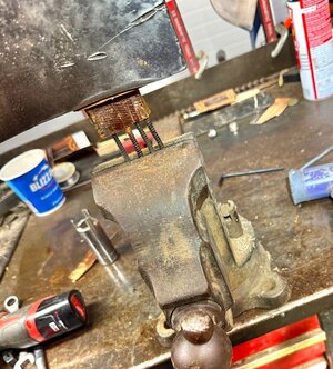

That is a different looking eye.
It's smaller, shaped different, bigger radius. You have to take a lot off to get it in, then spread it a whole lot to snug it up. First time I took too much off and couldn't spread it enough to snug against the big radius. A round wedge would probably work better. I could've been more patient shaping it too.

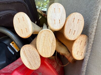

I've been buying handles 4 at a time from a guy in Slovenia, via Etsy. It's hard to get handles with the larger eye size here in New Zealand, even with freight these don't work out too bad Screenshot_20250905_231719_Etsy.jpg

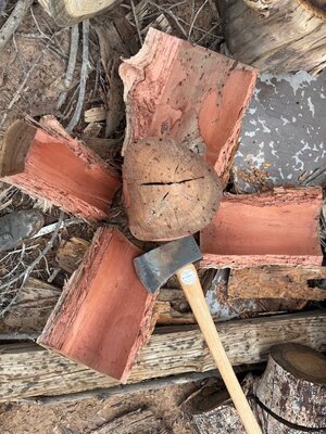

I had this 4lb Kelly woodslasher on a wallhanger curved handle (pretty grain but prone to break due to runout) and noticed it had a decent poll so I yanked it.
@IffykidMn
And stuck a council handpicked handle in it. Liking the councils. Good fit with minimal fitting.
New fave banger I think.
