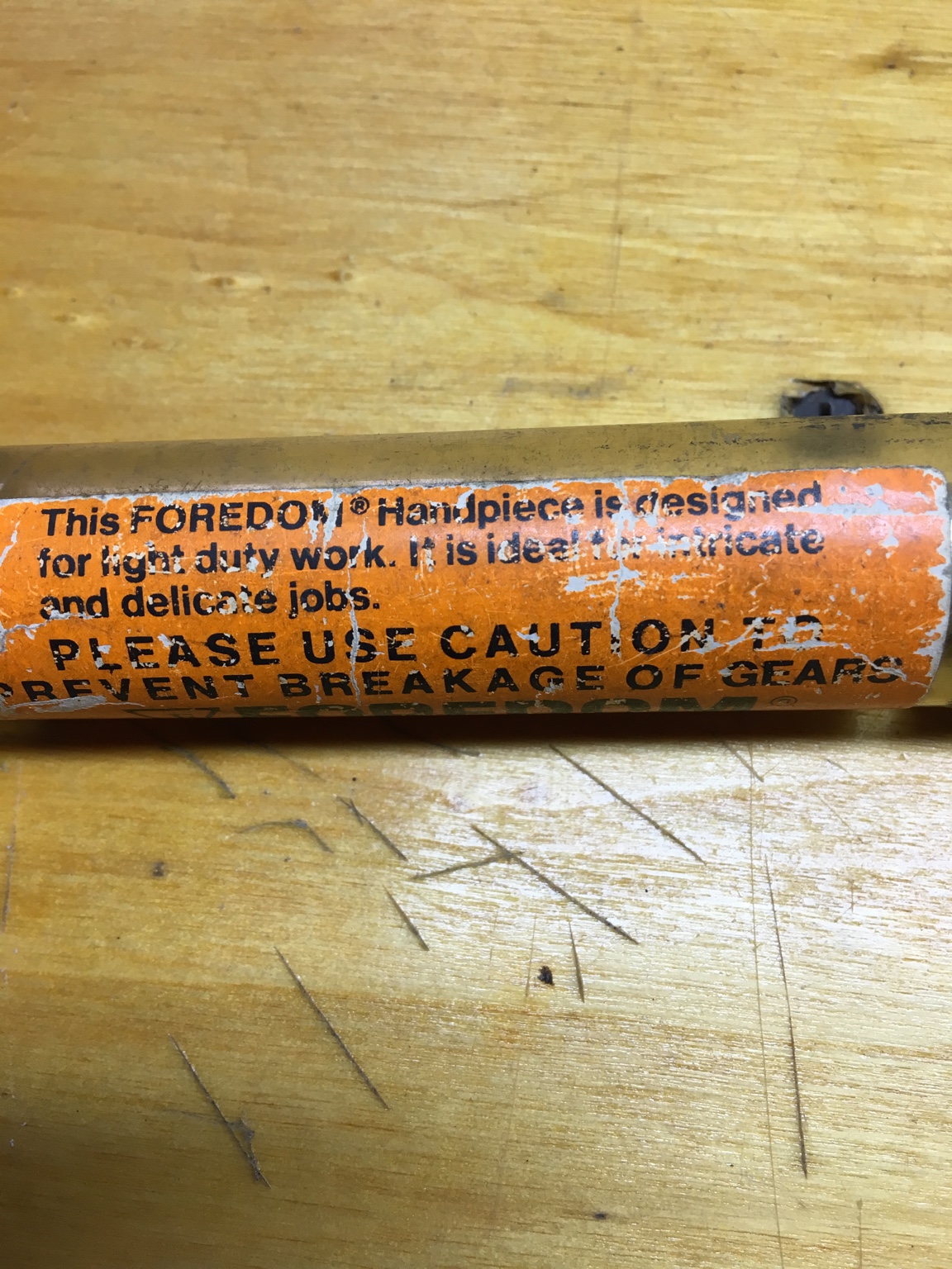

They are all foredom hand pieces. The 90 deg handpieces say
So I'll see how they hold up.

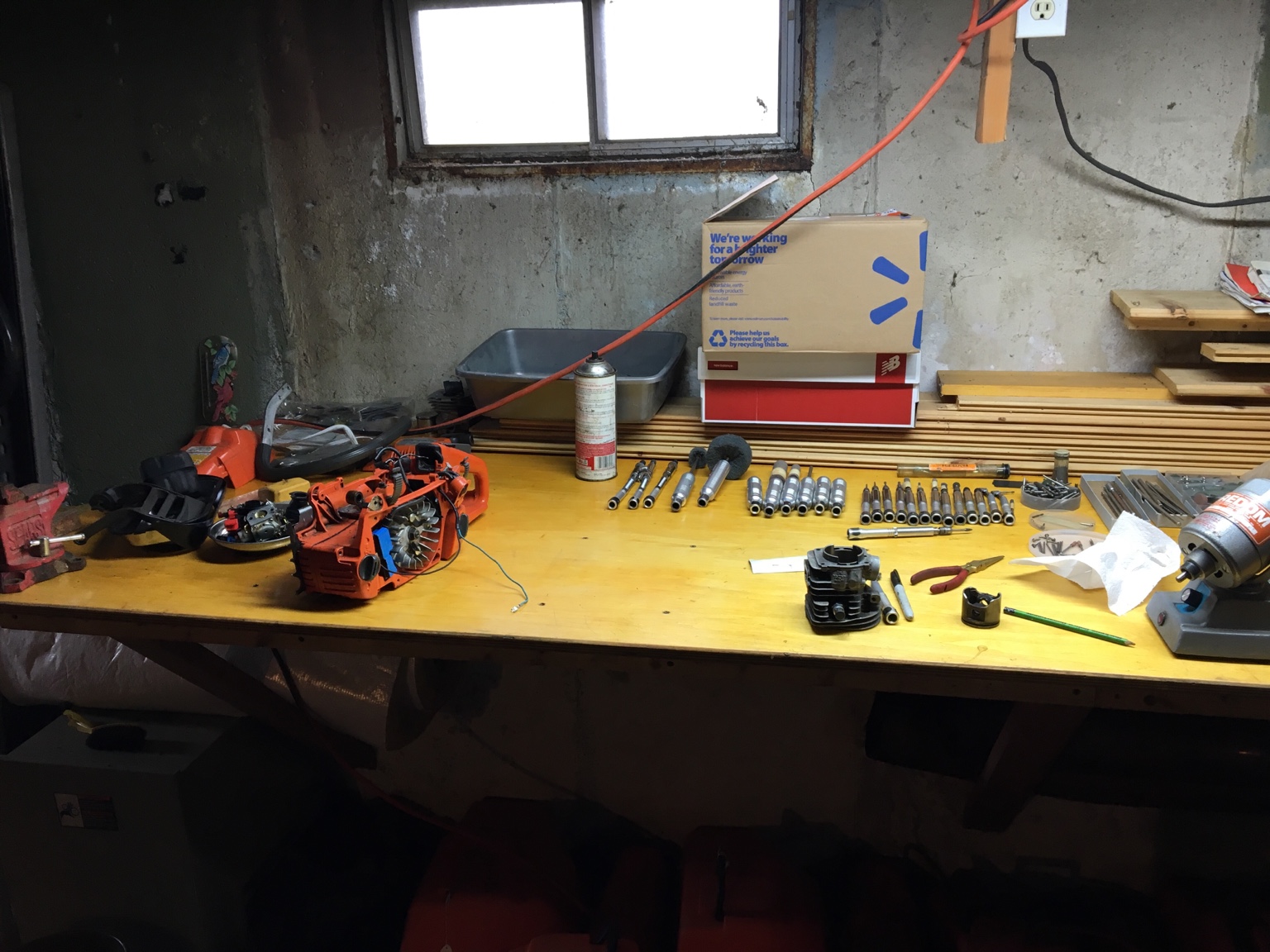

I just set up my work station this morning.
I think I'm going to widen the intake and exhaust a little, and raise the transfers a whisker.
Then I need to learn how to degree a saw and mark it out how I want to time it.
I have a roached 288 jug I may practice on.

Any tips?
For the small jugs, make the total burr shaft length about 1.5". I clip them with bolt cutters and finish the end on a grinding wheel. Otherwise, the back of the shaft hits the opposing side of the cylinder and messes up your approach angle.
Is your motor reversible? One L handed burr is a good idea for the final run. You wind up with different shaped uppers from side to side unless you do this. You're pulling the burr against its rotation, this will force you to go in opposite directions on opposing sides. You wind up cutting INTO the intake side on one side, and INTO the exhaust on the other. You can obviously get away without the L handed situation, I just like it.
You have to enter the transfer with your burr at an angle, or it will chatter. Randy E has a good video somewhere of how to cut with no chatter. You cut in first, and then slowly pull your burr across. Reduces chatter a lot.
Does one of your R angle pieces have a 3mm collet? My stupid 3mm collet was around $60 from CC Specialties. I wasn't too happy about that until I realized how much it saved me in consumables. You'll be able to buy (very much) cheaper Chinese sanding stones that seem to be mostly available in 3mm and not 3.125 (1/8"). A few 1/8" shanked attachments I bought were actually 3mm, so I couldn't tighten them into my handpiece.
Alot of this has to be self learned. Try to hold the handpiece with one hand, the jug with the other, and use one or two of your jug hand fingers to steady the handpiece as you cut. Gives you more control.
Some guys use rubbing alcohol as a lubricant while cutting. I found it of no use for me.
Good luck Dan! Post lots of pics.
Thanks Al.
No my motor isn't reversible.
Not sure on the collets yet. I've got to go thru all the bits and pieces I've got...
