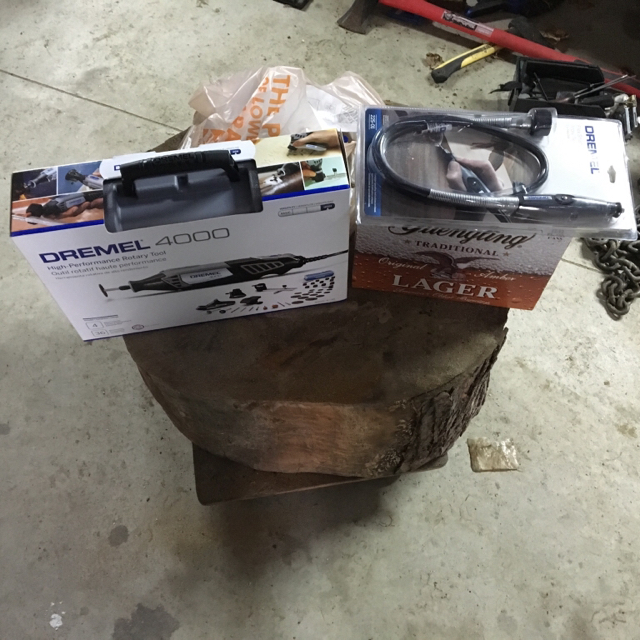

Just picked up some porting tools.
Recipe for disaster?
