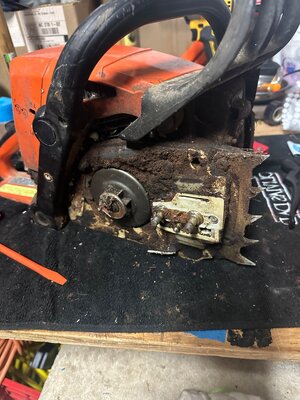

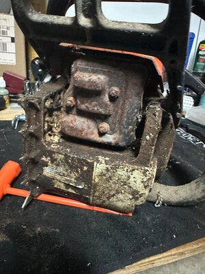

Stihl waiting on my 1127 ring compressor tool, however a coworker gave welding on the deflector a go. Looks like it will let some air out
View attachment 480512View attachment 480513View attachment 480514
Make sure you open up behind the deflector well, but it will get extremely loud if you drill directly behind where the pipe now is. That will be a straight shot out the exhaust port. I’d rather enlarge the two existing holes as much as possible, and that will really cut down on noise.

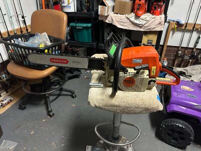

We have a chainsaw. A few things that were boogerbears in the assembly.
The ring compresssor tool works well.
The AV rubber grommet from the case to the main handle is much easier to put on with the chain brake removed.
The only thing left to do now is try to start it. I have both carb screws at 1 1/2 turns out. The other issue I’m having is the choke/kill spring keeps slipping under the lever when trying to put it on full choke. I may have bent it in disassembly or am just dense.
-did a very extensive muffler mod
- widen both intake and exhaust to 33mm
- Dukes pop up and Nikasil jug
- Dukes rim sprocket to 3/8
- Dukes mesh filter
- timing advance
