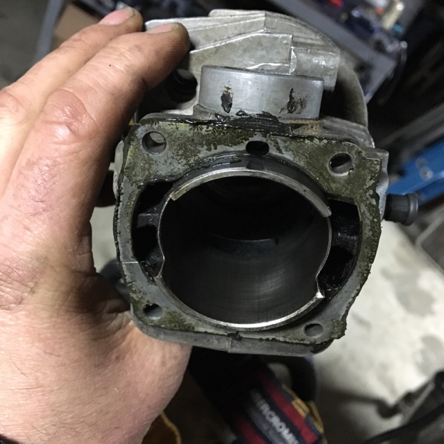

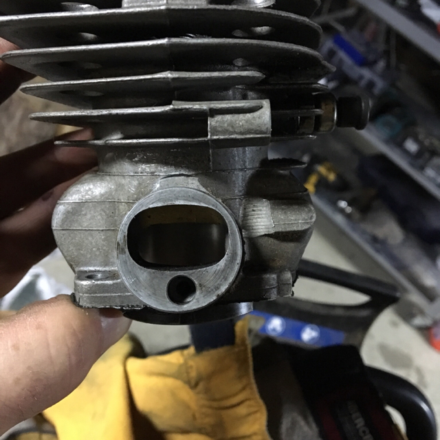

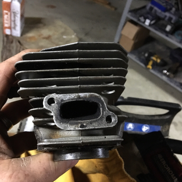

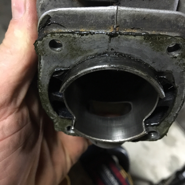

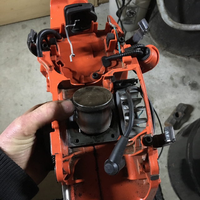

Here is what I'm starting with.

Square up the intake port some. I don't polish the exhaust to a fine shine. The transfers you can raise with a little patience and 2 of the thin cutting wheels stacked. It doesn't get the whole transfer shaped but will work for this first time. Match the muffler and heat shield to whatever you do to the exhaust port.
Looks like the intake boot is already smaller than the intake. So I'm guessing you mean square it up where it enters the cylinder? Than blend it back to the boot?

Just started playing with the dremel. Cleaned up the carbon out of the exhaust port. Wow! I can see this is going to take some practice!! What wheels are you all using for this? I've been trying a few but only a couple are small enough to even get inside the ports.

I use some cheap chinese carbides... an assorted set is pretty cheap... then finish with a small sanding drum.
I do upper transfers w/ dental diamonds and polishers.
