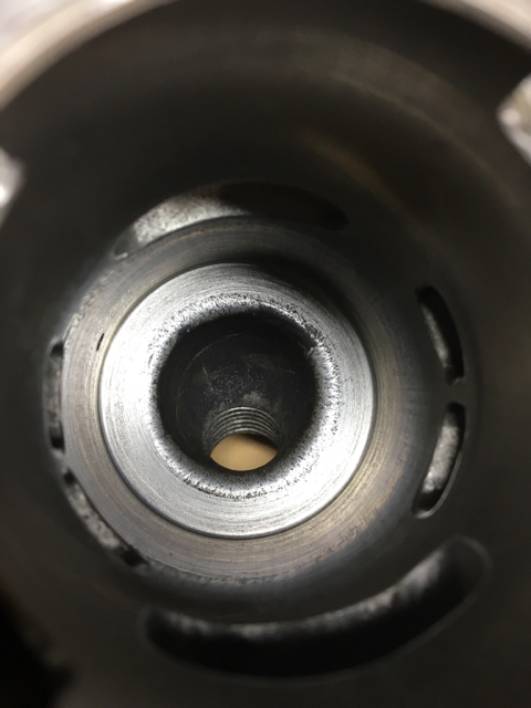

Hard to tell from the pictures, are you using solid solder instead of rosin core? That would make it harder to squish.
I'm not sure. But good chance it's solid. I need to get some different sizes or find some plastiguage.

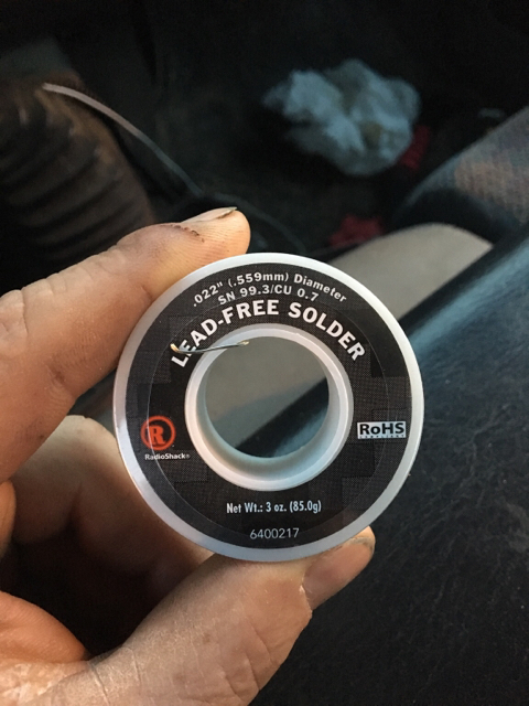

Just picked this up. I should be good now.

I think ideally you would want rosin core because it is softer but that might fine. The diameter is good.

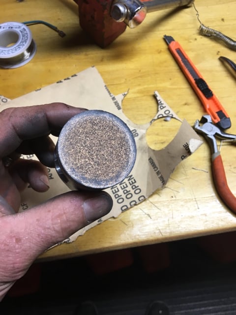

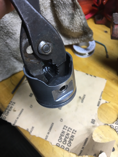

So I used 3m spray glue and 80 grit sandpaper on the aftermarket prison I had.
I just used a pair of pliers to hold and spin it.
It really didn't take that long. Only took 3 or 4 pieces.
Close enough for me. Do I need to sand smoother with lower grit? Or does it matter?
