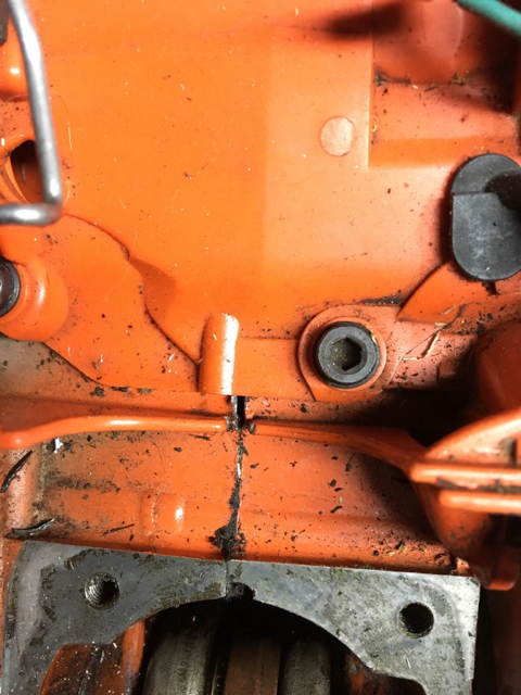

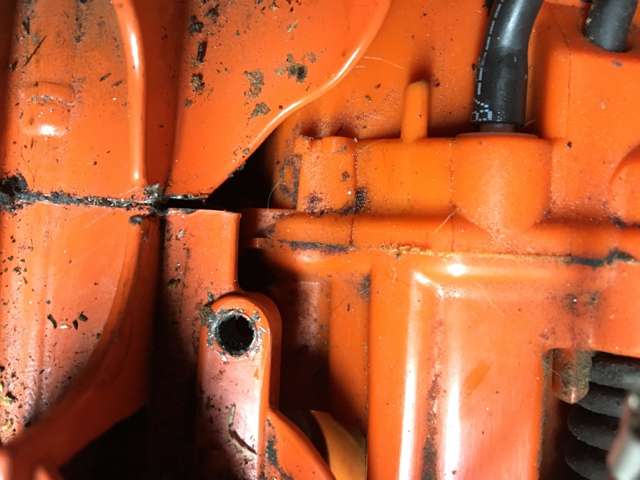

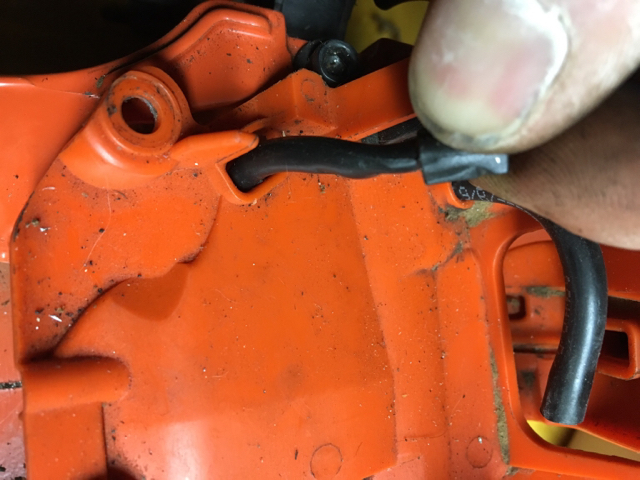

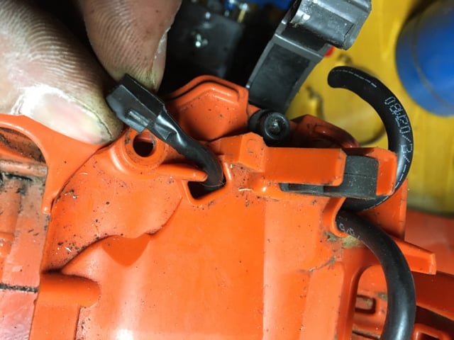

Well I was going to start putting her back together and this caught my eye.
So I looked closer and this.
Looks like someone started trying to separate the cases with a screwdriver.
And crushed a fuel line.
Looks like I need to examine closer.
