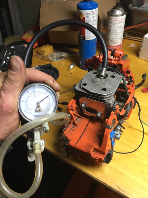

Ok. Time for the vac test. I use my compression tester hose with the shrader valve removed.
She's holding good at 8in.hg.
I just used the base gasket in case the seals were shot, even though I'm deleting it.
I'm going to check squish again with and without it.

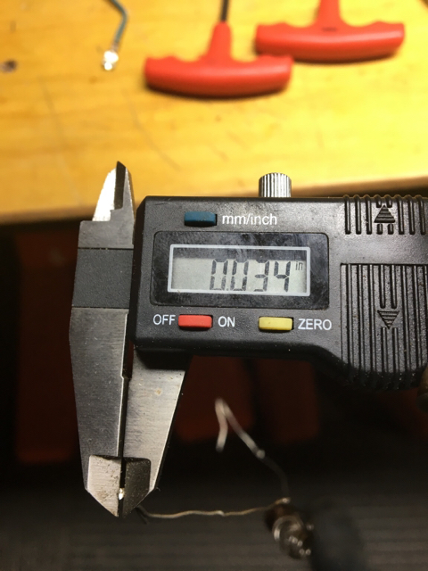

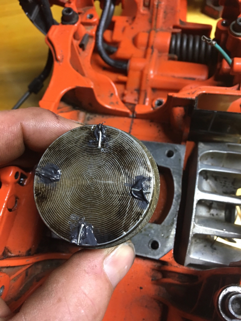

So I've always just stuck my solder in the plug hole. This time I did this. Interesting. I had .014, .0145, .0125, .014
So I'm guessing the squish band is inconsistent.
On a 50cc saw is this ok? Or really pushing it.
How thick was the solder to begin with?

I bet you're measurements are even tighter than that. That .032" at .014" will be .010" or so with plastigauge.
Yeah I was thinking as I spun the flywheel back and forth and could feel the solder that if I could feel it it wasn't crushed enough. I guess I need to get different solder.
I'll make it .020. I think I have a beer can somewhere. [emoji23]
If you have an old piston and stick on sandpaper you can open it up to .018-020".
