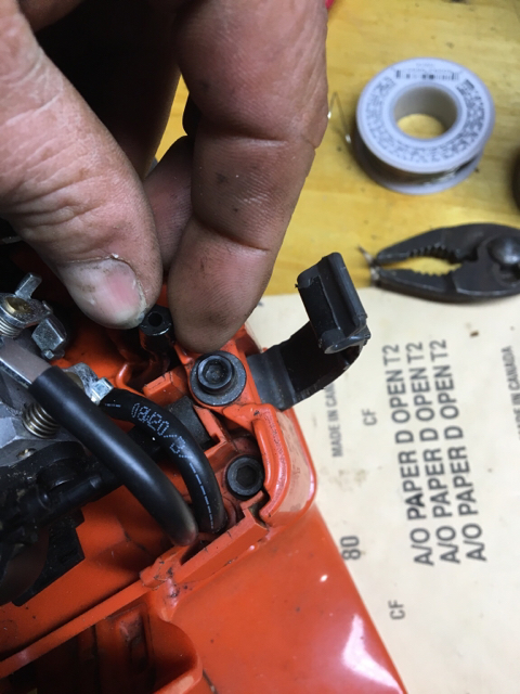

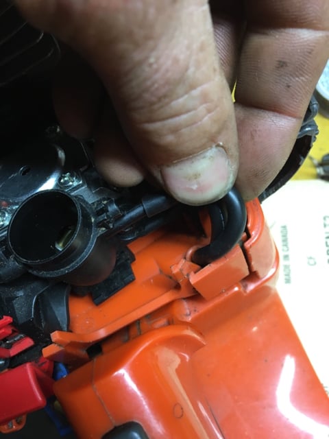

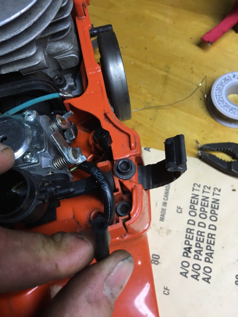

Ok so this saw was apart when I got it. I'm baffled. I've got the fuel line on.
This line
Goes here I think
But what about this one
When I push the fuel purge it shoots fuel out???
What am I missing??????

Prolly the purge dump back to tank. Need to hook it up to most forward nipple on tank. Remove carb box floor, see if you have an open nipple
paragonbuilder
7:17 PM
384
Jan 2, 2016
9,229
33,871
Norwich, CT
That was it! Thanks!
Not sure why it was up through the carb floor, but we should be good to go tomorrow!!!!

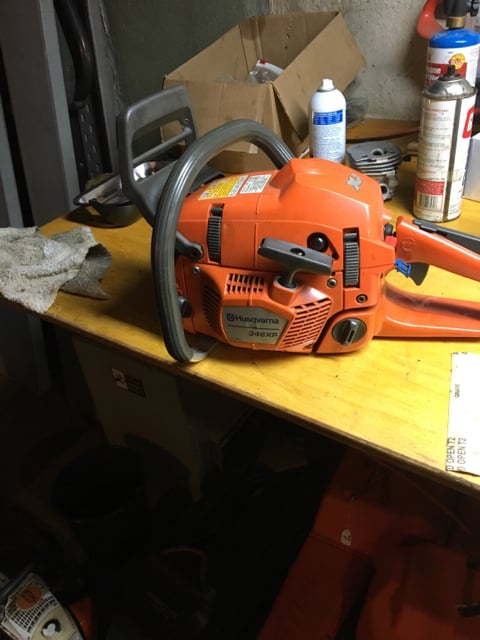

Got it back together. Tomorrow morning I'll look at his bar and chain, touch them up, put some fresh mix in her and hopefully get a good video!
