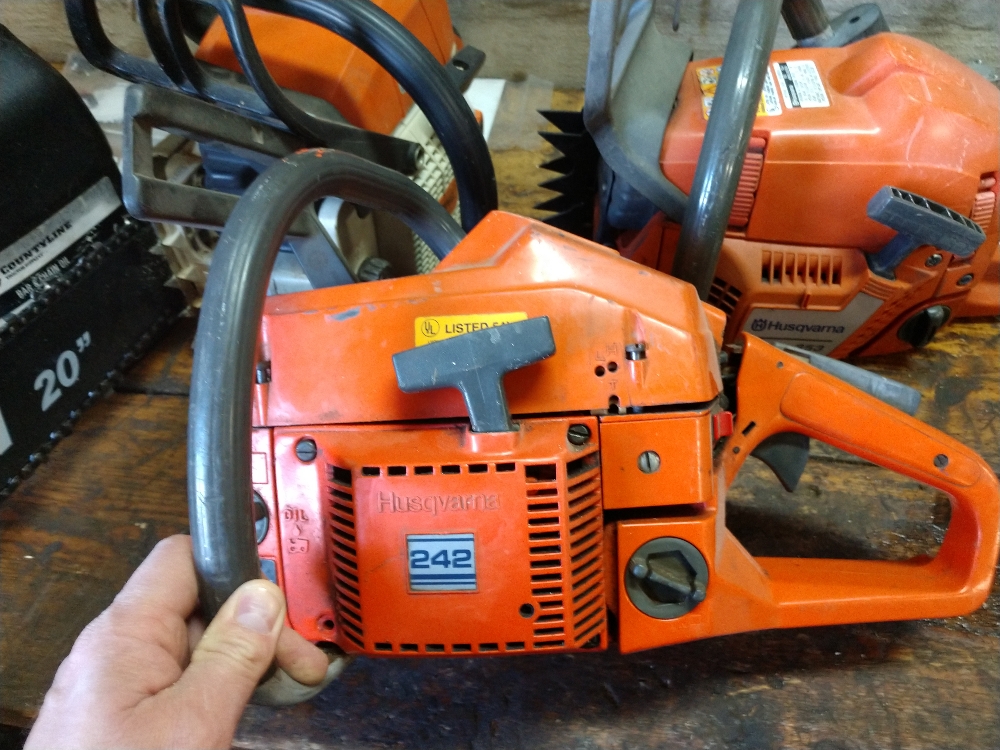

Got this little gem from Clint a while back. Finally took a look at it this morning. I'm pretty sure all it needs is the fuel system gone through. Bore is perfect,fires on prime. Anyone have the part number for the fuel line tank grommet??

They had two different fuel hoses, depend on what type tank it is, # 580 457 501 came around 1992.
If you have the old type tank you can use the fuel tank bushimg as they used on 262, # 503 735 801 and use fuel hose 580 457 501.
Most of the times I use the bushing so I can use same hose on them all.
If you dont have a 501 at home DJ, just use a 346 hose, its a tad longer but it doesnt mather.

580 457 501 Same as the 51/55 and a host of others.
Thanks guys, Parts are ordered.
