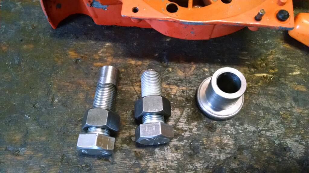

Welding the clutch hub to the bolt was a little sketchy. It didn't weld very well, the tig laughed at me so I migged it. Hopefully it holds.

I made the tools to mainly press the seals in square. That has been one of my biggest concerns. It'll be much better than the hammer and socket approach IMO.
If for some reason the case doesn't want to go together easily when everything is hot it will be handy to be able to pull them together without using the case bolts as well.

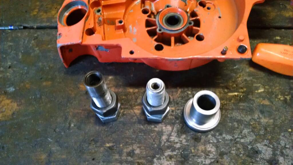

Here's what I came up with. I have a 372 ready to assemble so we'll see how they work.
looks awesome!!!

Nice tools thems are cool !!

I have made some plans, well, not sure if I nailed the big Huskies....
PTO all left handed threads. I sorted 362/365/371/372 away from 385/390 due I gone use a different socket (6202 vs 6203 bearing)
Tomorow plans is to check if I can get iron locally :D
