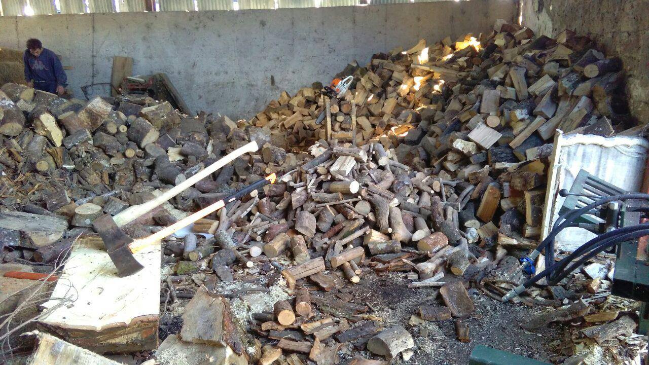

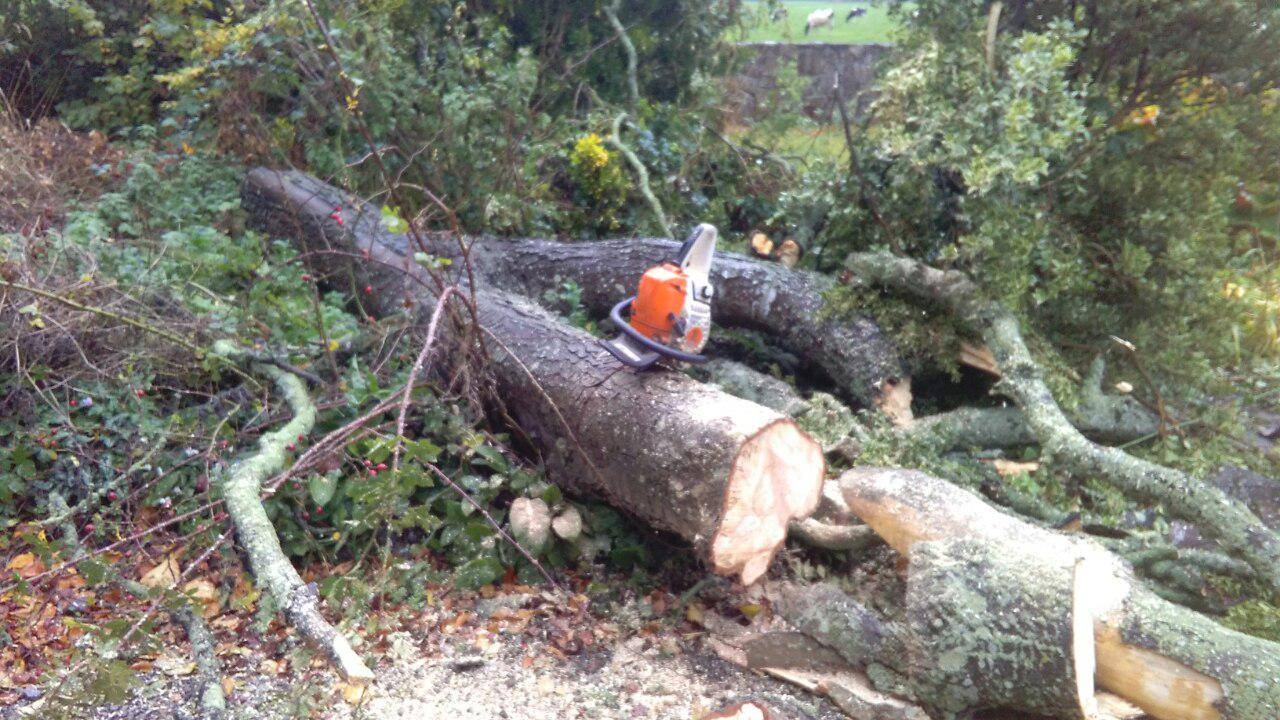

The more important question for my work is when I have to do the sharpening. 325 lasts a lot longer before it needs sharpening, especially if it is semi or micro chisel. It also rarely breaks on me. I have had a couple of 3/8LP chains give up.
Looking at the first picture on the right side What is the green gadget?? Thanks for your pictures.
