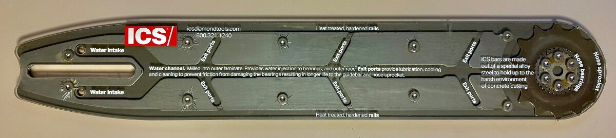

Seen at a recent trade show:
This ‘visible’ guide bar shows the routes that cooling water travels in an ICS concrete cutting guide bar.
On a more traditional, wood cutting guide bar, bar & chain oil follows similar channels along the bar top and bottom, and around the sprocket (not through the center).
Note all the roller bearings around the nose sprocket.
Although, the number of bearings and rivets (screws shown) varies, this basic design applies to most sprocket nose bars, and shows why good oiling is important. And why a small amount of dirt or debris can cause problems.

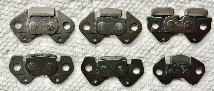

The cutters are a sample of different styles for cutting: brick, block, stone, reinforced concrete, sewer pipe, etc., with these special saws.

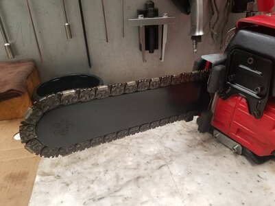

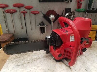

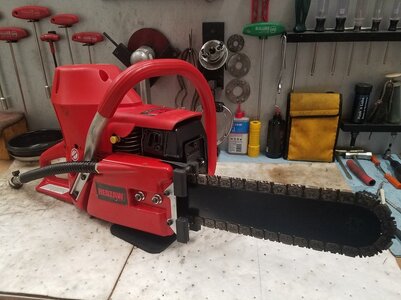

Cool. I recently worked on one of these and noticed that the chain needs water even when test running it, at least on a dirty/used chain. The lubrication system seemed quite effective, but I wouldn’t have guessed there was a channel running through the bar like that.
The one I worked on had the clutch all gunked up with concrete dust to the point that it wouldn’t disengage and therefore wouldn’t start or idle.

I have never used one. But the rivets on the sample cutters that I’ve seen, are all recessed back from the side edges of the diamond cutting blocks.
On the worn, salvaged chains, I have, the rivet heads are still slightly ’proud’ of the side plates.
