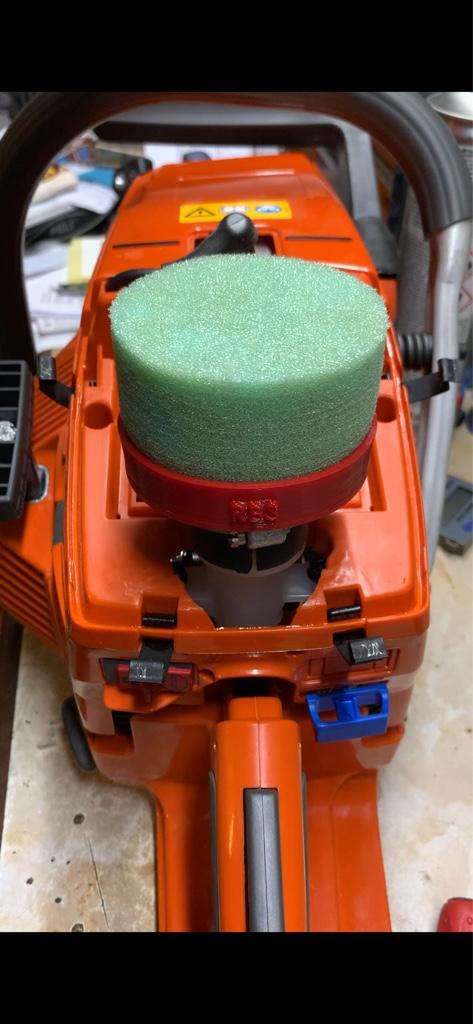

Just curious, that set up isn’t on there website is that a 2” setup ?
I’m not sure the diameter I’d need to measure it but I don’t have it to hand. I’m away for a wee while. It’s a lower top than the standard one though.

See the foams taller on these.

Those V stacks work very good , have a couple on my saws ,
Yeah I like them. I noticed a big difference in top end torque on a 372 big bore I built. It had a zama carb on it and it just wasn’t feeding it enough. Put one of these on and modified the top cover and it changed the saw.
Have a 2100 and 288 with v stack’s definitely good improvement on air flow , 273EA468-DC1A-40E5-9C53-226FDCB65117.jpeg
