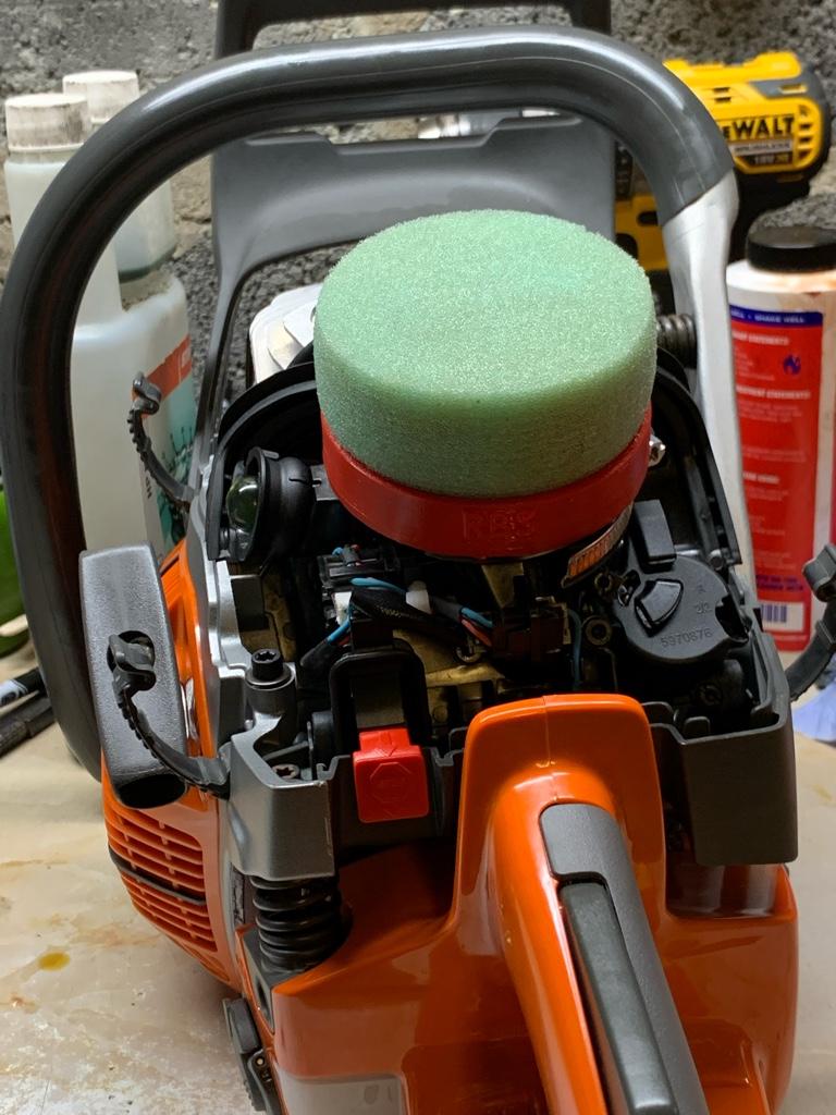

Mark great catch, there seems to be a pattern here.
I was staring at the butterfly for some time until I saw your cheat sheet pic#2, completely allowed since we are not in college!
And there it was, the periscope peaking at me.
@Bryan Newton is having some issues right out of the box with his saw.
@huskihl caught a few right out of the box.
My own 550 MK2 had an issue right out of the box before a drop of any fuel, caught by the great @Stump Shot.
I do believe that the very few exceptional builders here that care about their customers has its weight in gold!
