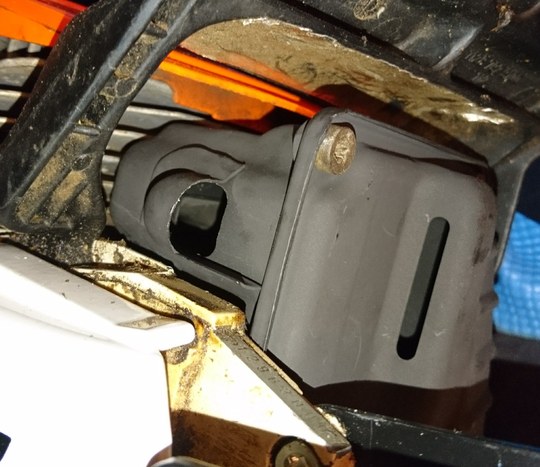

This is about how big they tend to be stock:
This is where mine ended up. Basically as open as I could manage without worrying bout it burning anything.
