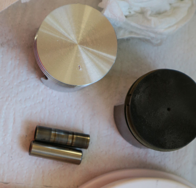

3mm+ per side is sloppy work, Meteor. I looked at mine earlier, and it is one simple process to grind out the channel for the rod. All meteor have to do is go with a different number on that axis. Just sloppy and lazy, Meteor.
ETA, looked at it closely. It appears the casting from the 12mm pistons might not have enough meat left on them before machining the gap. Maybe they would have to make a new mould. Still a bit gay.

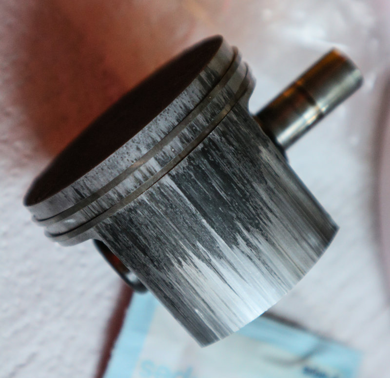

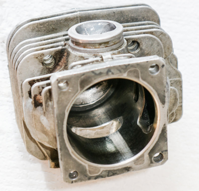

So, I had 3 saws on my bench today. Unfortunately, I only was able to address one. My printer died, so no porting Andrew's saws until I get a new degree wheel printed up, or find the one I left down south in Waterford when I am there. But I did find time to pull the 10mm 044 apart.
Here's the before and after:
Cylinder cleaned up easily - it was just carbon - no real damage to the plating.
Now for some numbers:
No idea what the timings are - printer is dead. But I never was going to change it. I only widened the ports, removed the lips from the lower transfers, ground out the exhaust some(you can see it in the second image).
Cylinder is a MAHLE 6+. So plus signs all over da place.

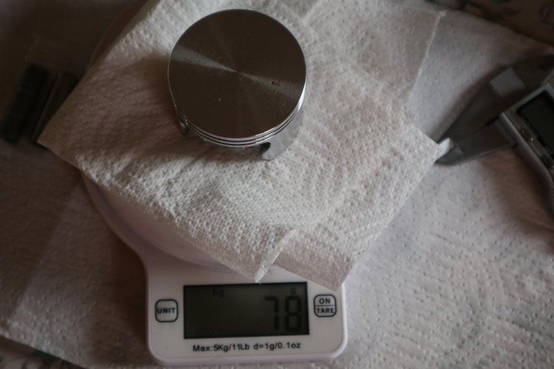

The wrist pin length on the Meteor is 33.8mm. On the OEM it is 34.9.
Piston gap for the con rod is 13.4mm for my MAHLE OEM piston. 15.2 for the Meteor.
So that's a cozy gap average of .9mm each side after installation. Not enough for the bearings to show themselves.
But still annoying.
Piston weight - OEM 75g. Meteor 78g(without rings). I didn't bother modding it.
After I got it together, I realised she was LOUD from the get go. Like maybe too much timing advance loud. She sounds like a piped saw. Well, OK, I did open up the front exhaust port by about 33%. I also was suspecting it might be a bit lean, so richened it up some. Still, when I went to start her for her third heat cycle today, she tried to snatch the handle from my grip. Unfortunately, the 044 was unsuccessful, and I held on, but the starter pawl paid the price. :( So, no 3rd heat cycle yet. I did rev her a little during the 2nd cycle, and she is very eager. Looking forwards to putting her to wood.

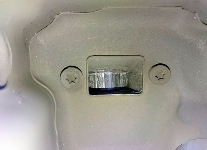

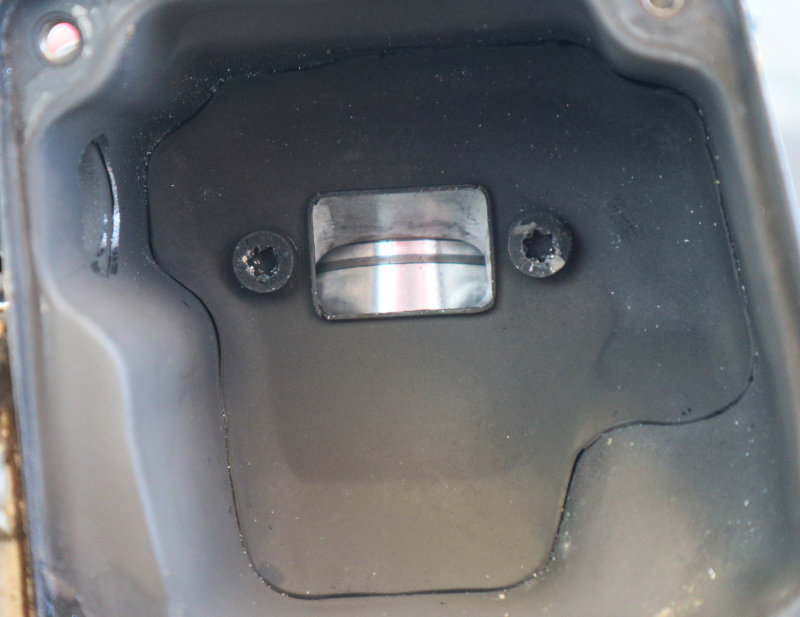

BTW, even though I didn't really add any timing to the intake, I sort of did. The intake on these are very curved and lopsided. I evened it out on each side and made the bottom of the port more flat. It actually was a decent amount of grinding. So though it may not have much more timing as far as the degree wheel might find, it actually opens up a lot more of the port a lot earlier. Well, I guess what I did was add duration ;)
