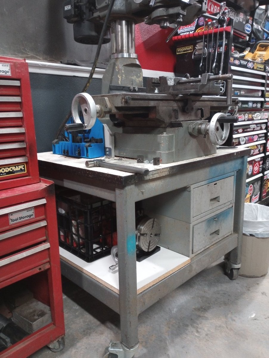

Scabbed together some shelving for my mill stand/cart, mostly organization for tooling and cutting fluids.

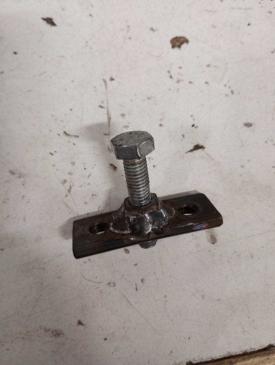

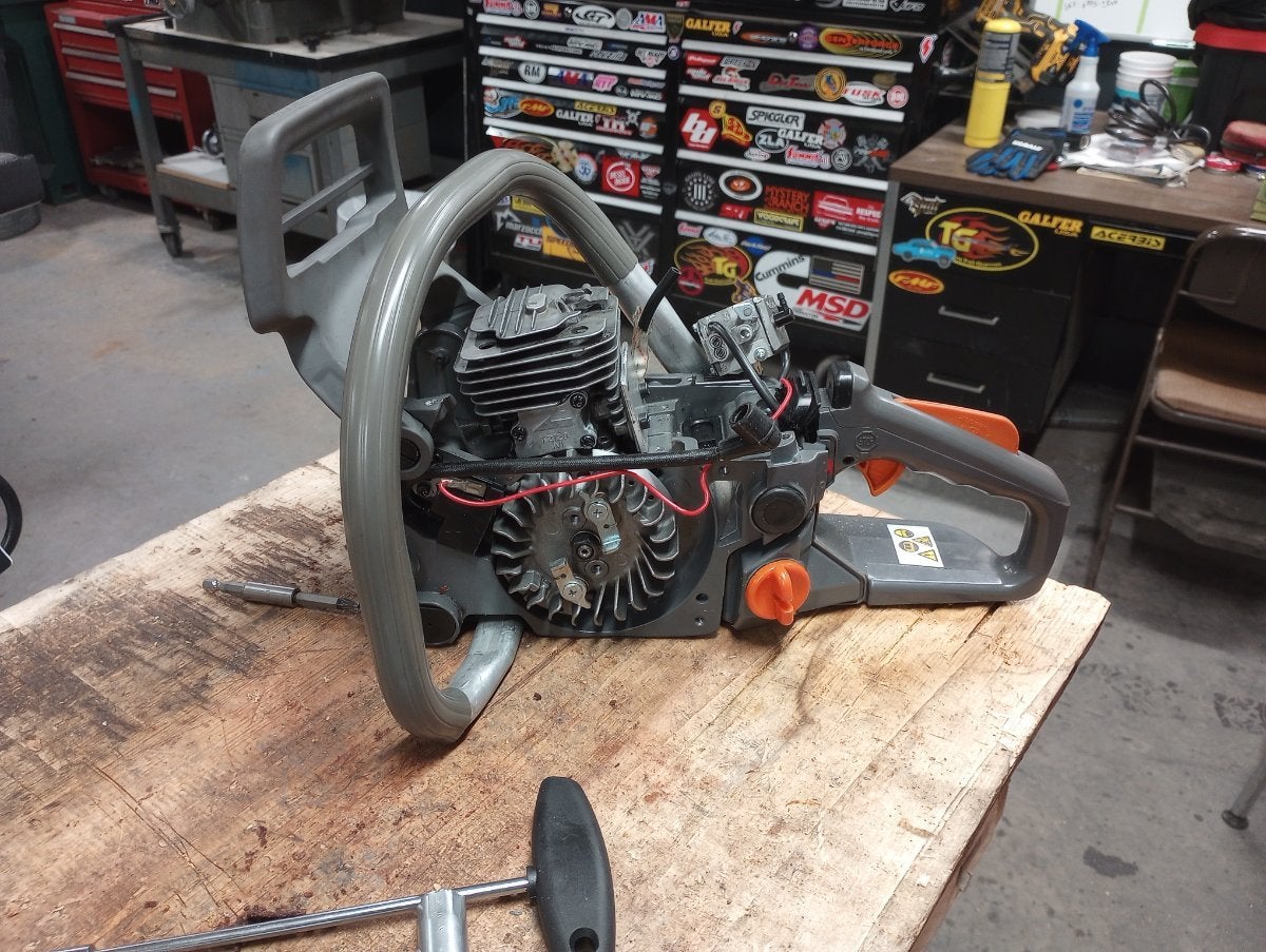

Also getting flywheel off a ChiCom clone of a 543xp was quite the ordeal. Usually I can get these off with a light tap and no puller. I had to make a puller for this one and then use heat and a heavy hand to get it to pop off. I'm pretty sure the timing came fubar'ed straight from one of Poohbear's factories...I'll play with it some more tomorrow.
