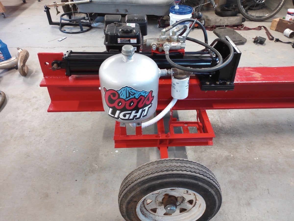

Got my home-fabbed log splitter mostly done today. I'm going to get some junk fire hose next time I'm at work and use it to secure/protect the hydraulic lines...also need to hook up the battery. I'll then figure out a table design for it after I get some time in actually using it.

Very nice. I think I would put some raised welds on the ram plate to keep the heel of the log from slipping.
