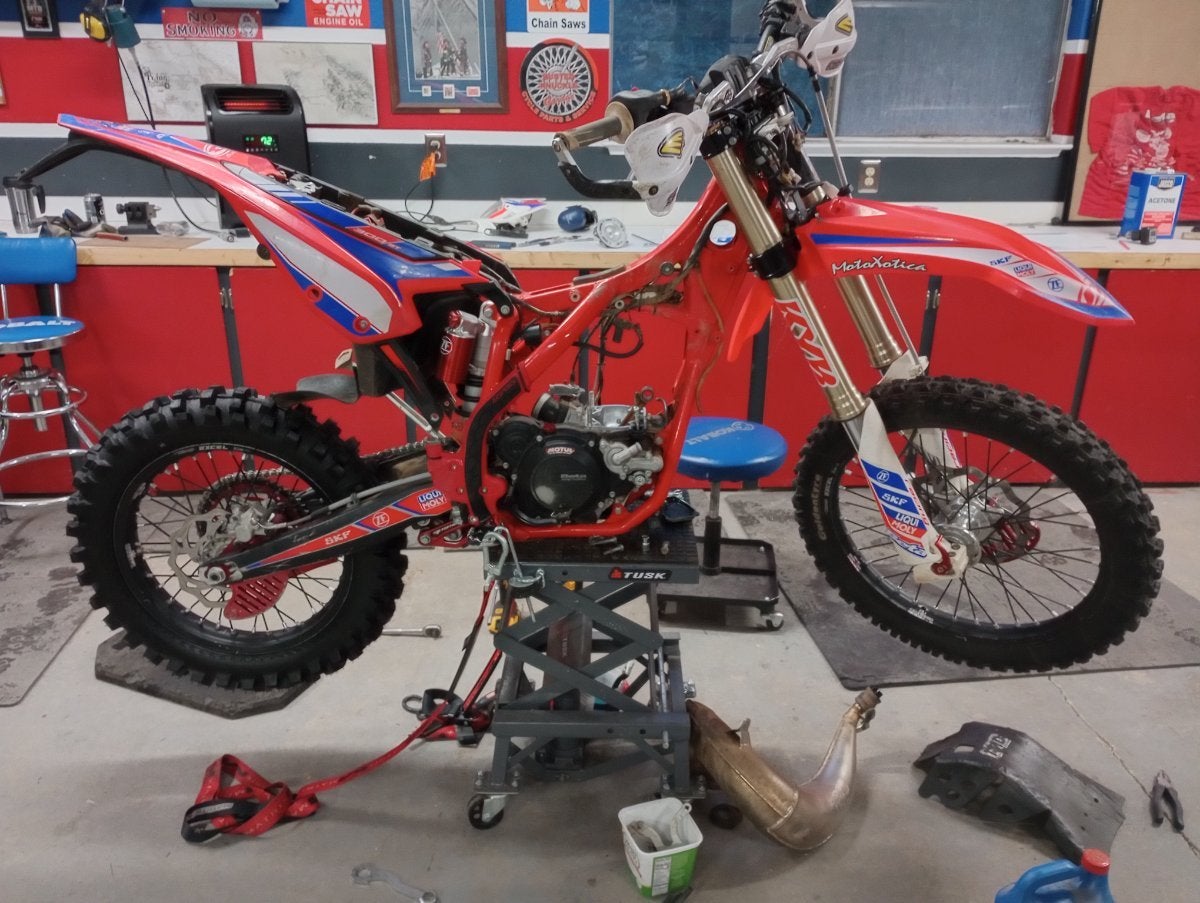

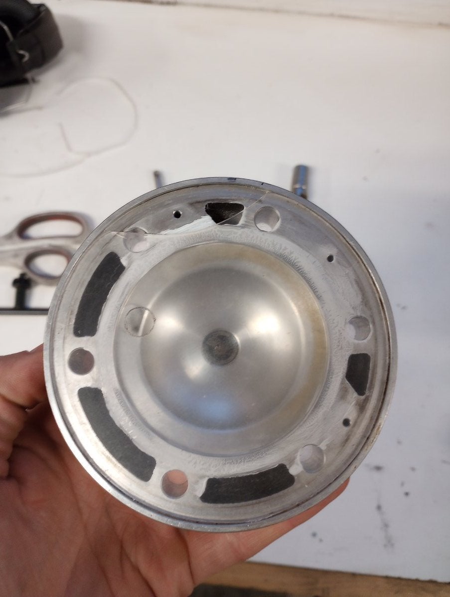

There's too much snow to ride, so I figure it's a good time to knock off some mods on one of the bikes. I did some mild work to the ports, these modern bikes are almost perfect from the factory...just some minor tweaking of the upper transfers. Also some timing changes to the ex port.
Next step is head mods, squish is really wide(.080".) I plan to bring it down to the .045-.050" range...got a baseline for head volume, as I'm going to machine the combustion chamber as well...I only want a mild bump in compression.
If I'm happy with how this turns out, I might mill the carb out to 38mm from its current 36mm configuration. The motocross version of this bike has more aggressive porting and the 38mm carb, and is still very ridable. This bike is designed with "ridability" as the priority...I should be able to make a "racier" bike without it being some unrideable monster.

GasGasKtm 300?
