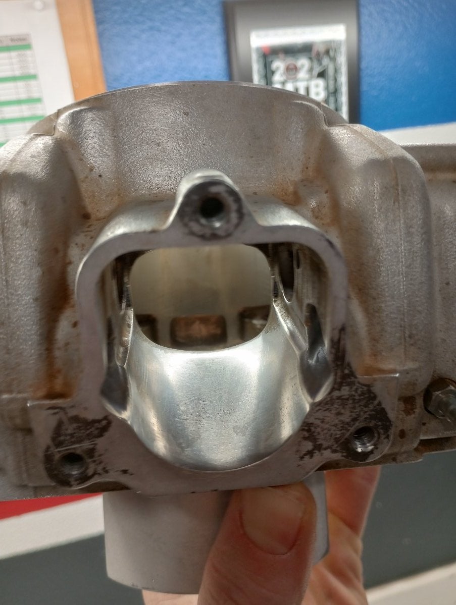

Some head mods and port work on the Beta 300. Very minor port work, just a few "tweaks." Most of the work was in the head, I took .025" off the sealing surface just to get to an acceptable squish number (.048".) That meant that the head volume was going to be too small, so I then had to cut the chamber. Stock was 33cc, I'm at 31cc, so I'll still get a healthy compression boost.
Imagine a saw cylinder having this big of transfers. BIG quad transfers and a boost port on the intake side. Intake is case reed, so no intake port in the cylinder, leaves room for the boost port.

Don't forget the variable exhaust port height / timing.

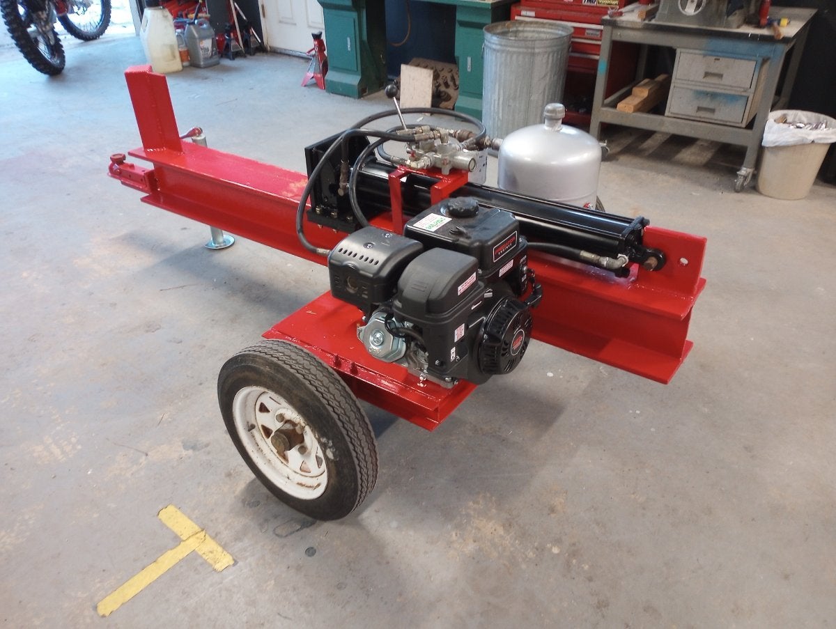

Got my home-fabbed log splitter mostly done today. I'm going to get some junk fire hose next time I'm at work and use it to secure/protect the hydraulic lines...also need to hook up the battery. I'll then figure out a table design for it after I get some time in actually using it.

Very nice. I think I would put some raised welds on the ram plate to keep the heel of the log from slipping.
