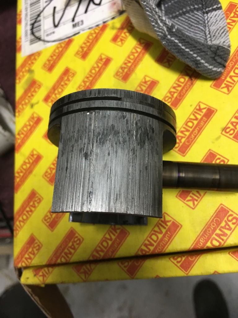

Since Alan told me about tweaking the side of the piston to match the intake and strato duration, I've been doing that. I think he was right......it does help some.
You are just smoothing out the pathern and match the piston ports to the jug Randy?
Any pictures so a dumb norwegian can understand? :D
2:43 PM
352,765
I leave the pattern alone. I just change the height of the opening point. Next time I do one, I'll get some pics.
that would be awesome.
I went to another forum today and digged up one old thread you had, back on the good old 13, your timings was:
Stock:
Squish: .034
Ex: 105°
Tr: 116.5°
Stratos: 71°
In: 73°
Ported:
Squish: .020
Ex: 105°
Tr: 116°
Stratos: 75°
In: 78.5°
If you did one stock 550, just to improve it a tad, would you change IN and stratos timings.?
2:43 PM
352,765
Stock:
Squish: .034
Ex: 105°
Tr: 116.5°
Stratos: 71°
In: 73°
Ported:
Squish: .020
Ex: 105°
Tr: 116°
Stratos: 75°
In: 78.5°
What changed the strato and intake timing was machine work. Deleting the base gasket lowers the cylinder about .025".
So what I did there was cut the squish about .030", then a little off the base to set the squish clearance at .020". Then I raised the exhaust and transfers back up to about the stock numbers. That gave me more compression, a tighter squish, and more duration on the intake & strato ports.
Now I would grind a little on the piston to make the stratos have 78.5° like the intake.

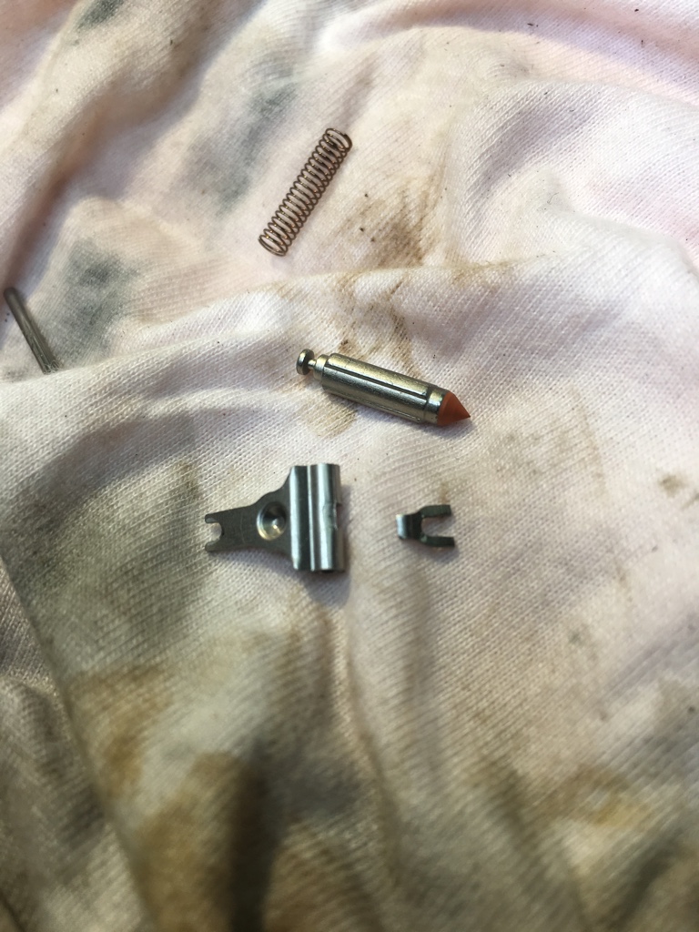

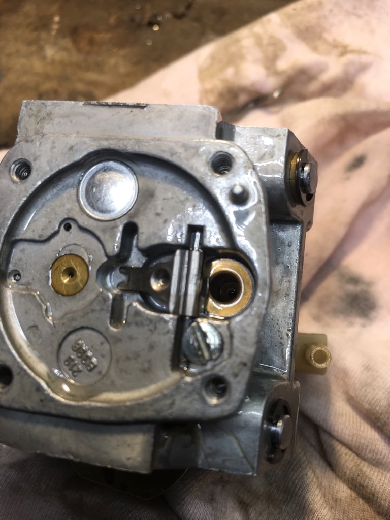

A dirty bench top but a sparkly clean 084 [emoji12]
Ran the other 084 today ran ok for a few minutes before something happened with the carby and started flooding itself.
Can see the fuel flowing down the front.

Looks like a fireball waiting to happen.

Lol funny you mention that. Pulled the plug and pulled it a few times to dry it out. Had my self somegreat fireballs coming out the plug hole. [emoji12]
You know it Randy . Everything with 084's is go big or go home. [emoji6]
