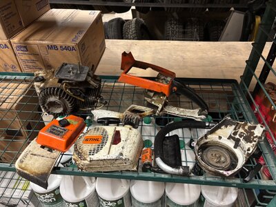

Next up is a 42 special I'm going to repair for a friend, coils & wires.
After that comes a 262 I'm going to go over before it changes hands.

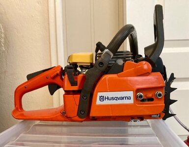

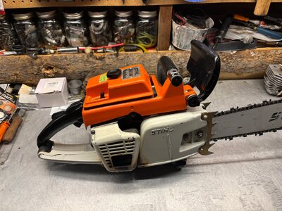

Hey, @Tor R ....
On this 242xp I have. I'm starting to think it has the wrong coil. I swapped carbs and still can only get 13,9 out of it. Turning the h screw much past 1 out and it starts to die rather than increase rpms. Thoughts?

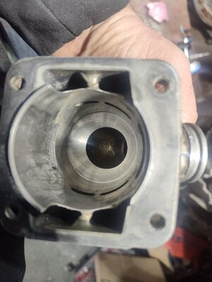

IMG_9707.jpegGot everything now, new old stock cylinder and rings thank you Mark for the rings, piston is in great shape after I shaped it and it micrometred every way which way but loose, my favourite Clint Eastwood movie, don’t forget every which way you can. I love it when he beat the *s-word out of the bikers and they end up working together kind of like government yet not?

Hey, @Tor R ....
View attachment 479223View attachment 479224View attachment 479225View attachment 479226
I don't think the series had bad coils even though they changed a bit along the way. I don't think they had rev limits on them.
Unported, I usually start at H 1 turn out, but tend to end up many times with a little less H than that. But never below 3/4 before I try another carburetor.

View attachment 479227Got everything now, new old stock cylinder and rings thank you Mark for the rings, piston is in great shape after I shaped it and it micrometred every way which way but loose, my favourite Clint Eastwood movie, don’t forget every which way you can. I love it when he beat the *s-word out of the bikers and they end up working together kind of like government yet not?

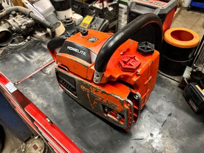

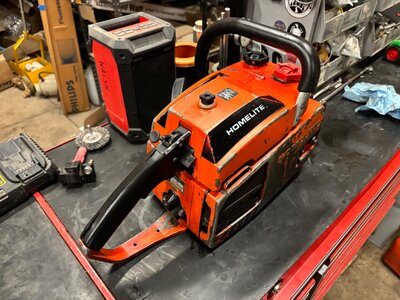

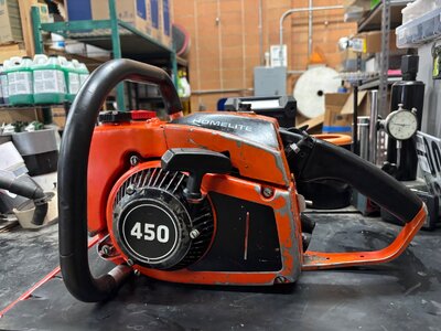

Who wants to see if I have it?? I got so many saws, I don’t even know what I got. Not really, but really it’s called drunk bulk buy. Not bragging I’m just looking for experts in their beloved field. Unfortunately I love them all unconditionally so I can’t become an expert. I do love my homelite and I am a Savant with homelite and proud of it
So, that looks like the right coil? 🙁
I have 1 more rebuilt carb to try.
