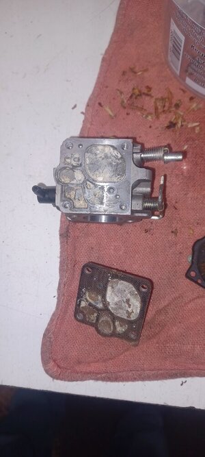

Hmm....don't think I can salvage this one :(
Way too much corrosion.
Whether to save it or not depends on how rare the carburetor is. Hitting that with a sandblaster and polishing the face would bring it right around, but there might be damage to the needle seat.

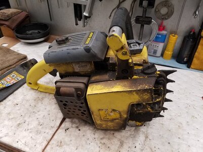

This Remington SL11 was pumping a lot of air and very little oil. The pickup in the tank was pretty plugged and the line from the oil tank to the pump was a bit loose on the pump end.
All cleaned up and everything works now.

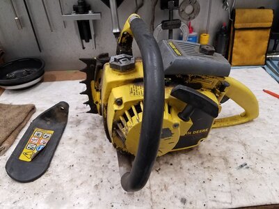

Next up is this Homelite Super XL dressed up in John Deere yellow.
It is locked up currently. I will get it apart and decide if there is any hope. I have some parts saws in the attic, or I may just clean it up and make it look nice for the display.
The corrosion is localized to that one section. I wire brushed a lot of it off after quite some time in the sonic tank. But, how much is in the top passages that I can't get to?
Early 066 carb.
Early 066 carb.
By top passages you mean the mix needle passages? Usually corrosion doesn’t affect them as much because they aren’t sealed like the pump chambers.
I can get the larger ones with carb brushes. The tiny, .030 passages into the body of the carb, not so much.
