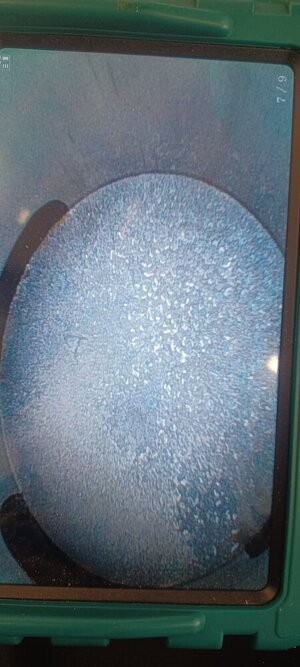

I don't think the series had bad coils even though they changed a bit along the way. I don't think they had rev limits on them.
Unported, I usually start at H 1 turn out, but tend to end up many times with a little less H than that. But never below 3/4 before I try another carburetor.
Steve has pointed out that his 242 has the same limitation. Cause: AM Meteor piston.
The cyl is a new Gilardone but I haven't checked to see if it has a stock windowed piston or a closed Meteor.

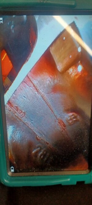

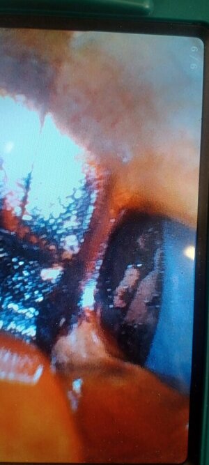

Well...a KS piston with 2811 showing on the inside skirt via scope. Hmm...
View attachment 479297View attachment 479298View attachment 479299
If Meteor 242 piston is used it becomes a low compression turtle, with the same intake timing as the old 42 had.
On Gilardoni 241 C or was it A (I always mix between 42 special and 246) KS piston was used.
To start troubleshooting your 13.9k problem, if you don't have spare coils, you have to start with carburetor diagnostics first, stock, I can never remember having a carburetor that needed a richer mixture than H=1, almost all of them ended up a little leaner, usually down to 3/4.
One problem that I have seen very often is that the speed trottle does not reach maximum, the only fix is to bend the speed transfer so that you get full speed.
An HDA-98 usually works fine and is pretty easy to tune too, never really a problem to reach 14.5k, and never a problem to reach 15.2k on 242.
