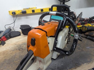

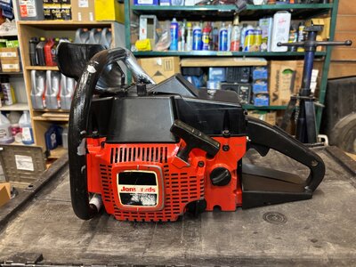

What will you use to re-wrap it?
Probably just going to get a simple hockey tape job.

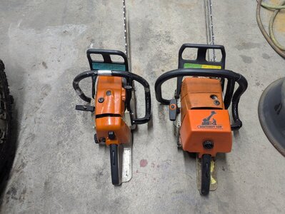

Got the top dropped, had to order a little tubing to finish the leg back by the cylinder.
Proportions worked out exactly how I wanted, looks like mini me compared to the 461. The big saw has the same handlebar installed.

That's a slick job there.

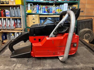

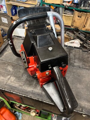

The other Jonsereds 910e is also cleaning up nicely. Replaced a rear AV bushing and rear handle assembly. This is going to get new fuel tank vent, impulse line, fuel line and filter, and carb kit.
I had a good one, but sold it for fear of damaging that coil mounted to the
plug wire! What were they on when they thought of that?

Did you just cut and weld that last section? Came out amazing.
That was where I had to actually buy some tubing. I moved the plastic bracket/mount up the tube as far as I could then cut down the rest till just before it stops being round then made a new piece to go between. Definitely learned a lot about welding thin aluminum and getting a TIG weld into an odd spot on this little project.
