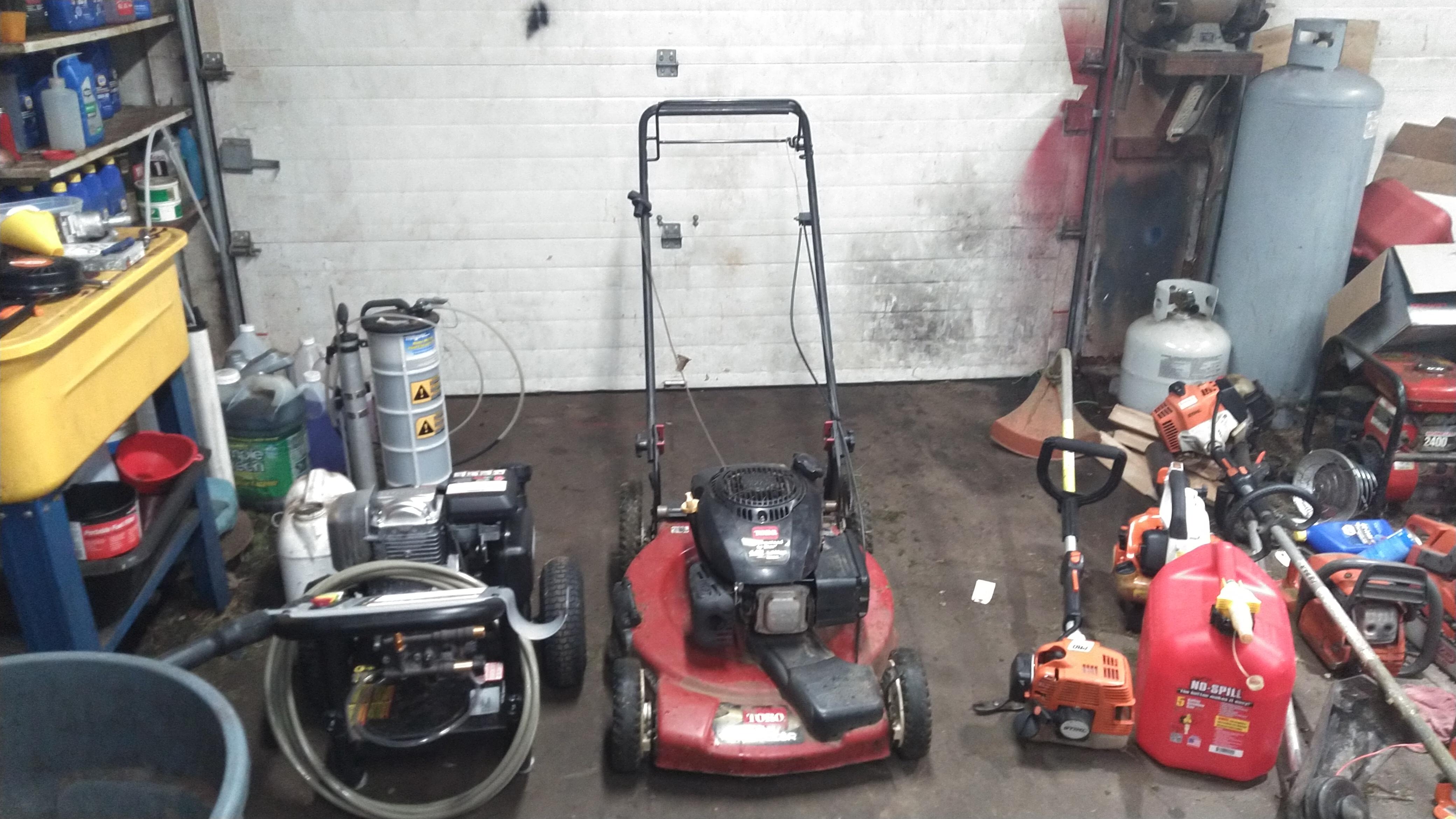

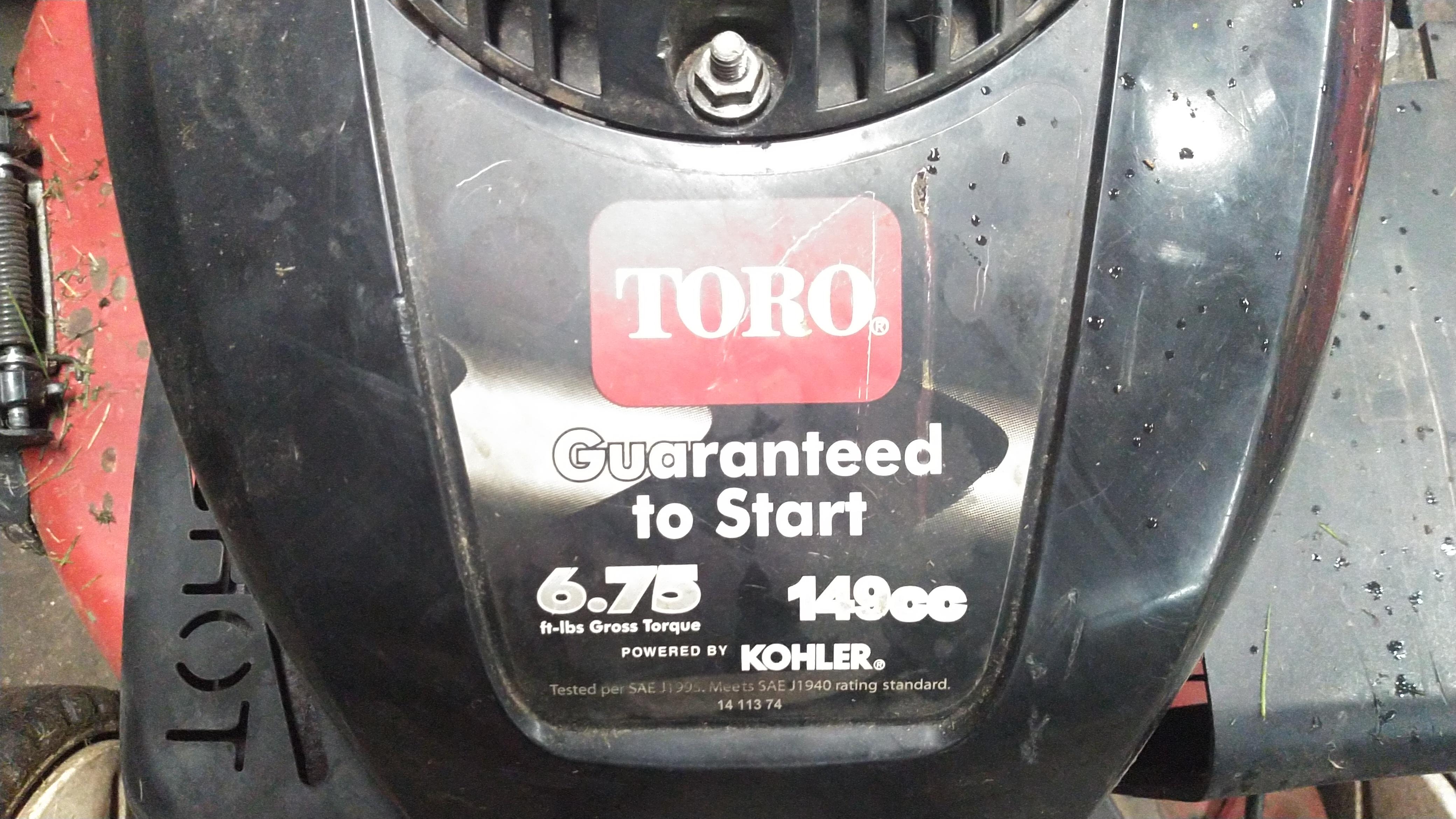

Toro Recycler with a Kohler Courage XT675, got a new choke thermostat for the auto choke system. He also brought me his FS94R that the muffler came loose on. Put the muffler back on and put some red locktite on the screws. Also found a missing starter pawl so I ordered a new cup/pawl assembly. He has a backup trimmer to use while I'm waiting for parts.

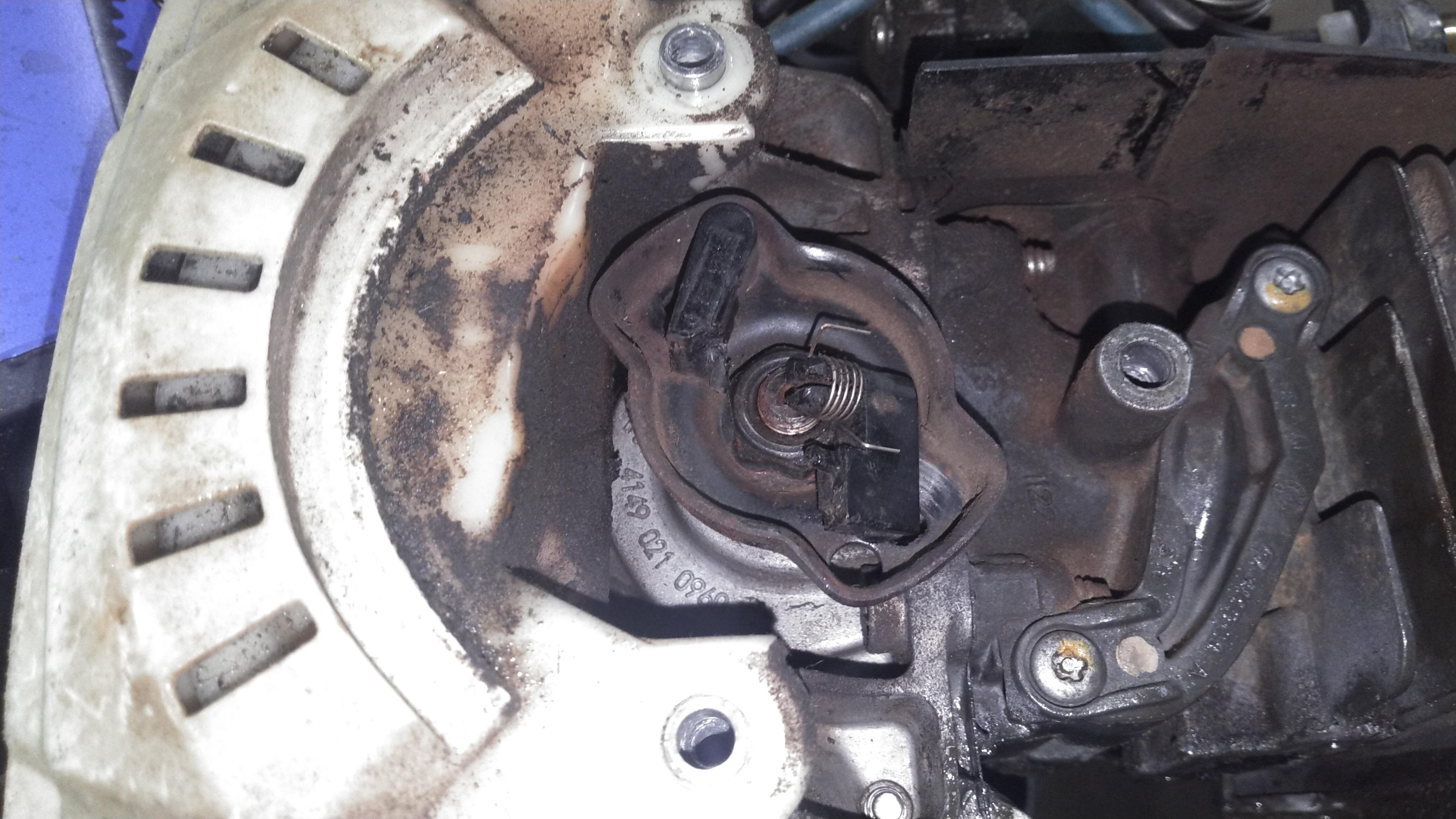

Its in the wrong side of the case?
Yes sir.
I started stripping the saw because the case gasket failed, leaking bar oil, pulled the front upper case screw, very short, wtf?
Helicoil appeared to just be holding the dog, no case compression.
Worst thing, the thread in the flywheel side case is 100% perfect and undamaged, never needed to happen.
