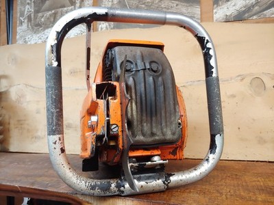

mystery full wrap handle...
This isn't aftermarket or from a 2100 Husky but I wonder what it was originally. Mac? The side grip tooling should be a giveaway.
1100CD handle.

It’s a HD pro safety for a 1100CD etc . I’d buy it but price doesn’t match condition
Ah, so it is an old PS. With the side tooling I figured it was 50s Mac :p
Shipping from Canuckistan is the real killer…plus the duties.
Looks like it could be restored and painted to look fairly new.

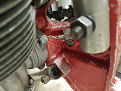

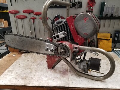

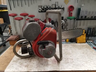

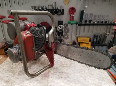

The Lancaster 400 is done, runs on prime. Since it is going into the display I didn't want to make a mess with fuel and oil.
The high top front handle (bar) is the oil tank. Gravity flow to the bar pad, the oiler valve is opened when the throttle is opened

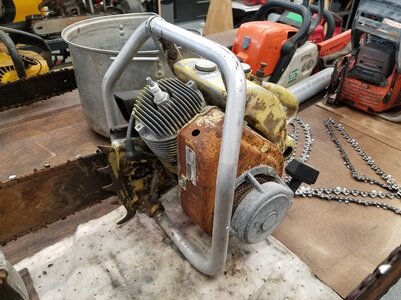

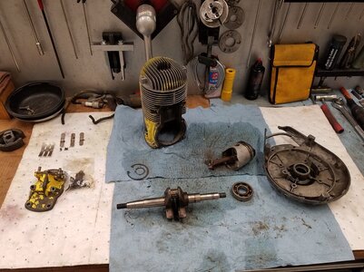

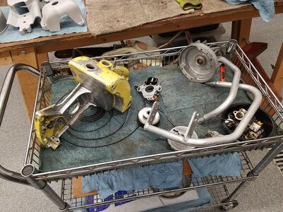

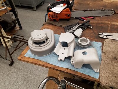

Next project, maybe the last before the Open House 8/9 May is this Mozwood. Mozwood saws were made in Durango, Iowa in a small shop run by a man named Elmo Jameson. They bought engines from West Bend and had other castings made in the Midwest. They were also a dealer for Propulsion Products Titan saws.
It was pretty rough coming in, and stuck tight. Turns out it was the flywheel side bearing, not the piston and cylinder that was stuck.
Since the paint was in such bad condition, and the flywheel cover all rusty I decided to give it the full Monty in preparation for the display.

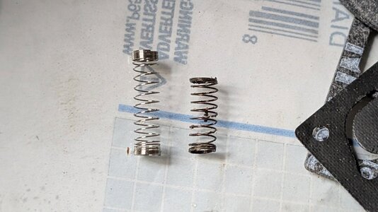

The Ford chainsaw is a runner. Someone had apparently been into the carburetor and lost the needle valve lever spring and replaced it with what they thought would be an equivalent. Over 40 lb of pressure would not pop the needle valve off its seat.
